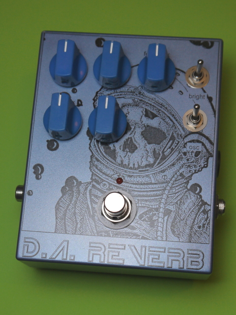

Hi guys:  like it says, everything is fine with this reverb..in fact its great....but.....
i added a bright / warm-normal switch, (using middle and outer lugs of an spdt) , and i just can't get the bugger to not 'pop' when switched. (used a 47n/22n as i didn't have 68n ::))
ive tried all sorts of remedies to no avail....any solutions,  i have it on breadboard so i can try any suggestions!!!.. :).  cheers guys.

edit:  R.O.tree (mike)  suggested a 1M from VB to the right of the switch caps, ...much much better.!!!!... thanks mike ;)
For one less part, return the bottom of R15 to Vbias.
However a large resistor across the switch is a good general plan when a cap runs from mid-voltage to ground.

@jon: never heard of that, this was originally the 'box of hall schematic' , but it was way too bright  compared to bypass signal imo, so i tweaked the 'tone' of it,
armndry(larry)  suggested the feedback idea...which is really cool, (R13 sets the max feedback) lower values with self oscillate, but i have it just on the edge of that.
i added the bright/warm  . warm being 'normal tonal unity' , and bright which just lifts it, which is really sweet with my electro acoustic , and nice n plucky on my ibanez rg470. a cool option.
i also added the volume so i can tweak volume of bright/warm, plus i'm pretty much a control freak...well worth a build. sounds great with delays/chorus etc...and nice to have it under foot rather than on an amp. ;D

aha...mike (R.O Tree) suggested this, and it works great, totally silent switching.  excellent. cheers mike. ;)
i shall try some other fets too just to try...
revised schematic.
sorted. ;)

If you're short on PCB space, Paul's observation that the cap needed to be "pulled down" is one part instead of several.
Your pop was for the same reason that input and output caps without pulldowns pop on effects. The cap gradually leaks down. If you're switching a cap carrying audio signal, you always need to pull both ends to a DC voltage that is not changed by the switch operation. Otherwise, the cap will have to charge, and will then discharge depending on the switch state, and you'll get a pop.
In your case, pulling the switched end of the cap to Vb with a large resistance, maybe a meg or more, would do the trick. So would Paul's trick of pulling the "ground" side to Vb if you also pulled the switched side to Vb.
It lets you use fewer parts. But the JFET switch works too, by making the transition very slow.
cheers R.G.
nice explanation, thanks.
ive managed to squeeze the fet circuit on there, i did try pauls suggestion but there was still a little pop, not as bad but still noticable.
ive been trying this fet switch all day and its fine. 8)
