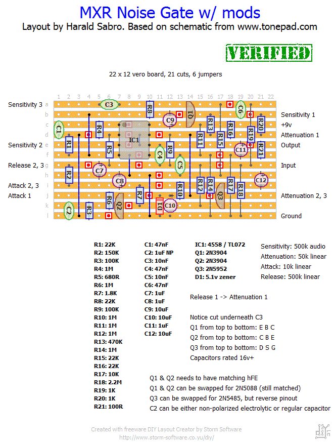

hi,
every so often i build something out of boredom and happen to like it enough to wanna use it live. i'd attempted an MXR Noise Gate before, but i kinda half-rectumed it and didn't bother since. so i made one the other day, following a layout based on the modded Tonepad version + fixes, and it works great. it doesn't screw up my attack as much as i thought it would.
this isn't such an issue, as it's usable as-is, but my Sensitivity/Threshold pot is quiet for the first 1/10th of the turn then suddenly it just lets all the noise through at full volume. no gradual change, it's night or day - which may or may not be similar to an issue reported by others. now, i'm awaiting some of the recommended 500k Log pots as i don't have any, but i have a feeling that's not the issue as it occurs with the 1M Linear pot i tapered down to 500K pseudo-Log, a bare 1M Log pot, a 500K Linear pot and a 50k pot (which confirms that it's at about 20K where the gate suddenly lets everything through). i've tried all the suggestions, but no luck. worst-case scenario, i could just get a 20K pot and leave it at that, but that'd limit functionality somewhat.
points of note:
-i've changed the 680R resistor to 4.7k, and the following cap to 2.2uF
-already performed the 1M -> 1.8k resistor change
-i have 60pF (2x30pF caps in parallel) between opamp pins 1 & 2
-i'm using matched 2n5088s (~370 or something hFE - some say this is too high, others say matching matters but not hFE - either way i dont want to change these, as apart from the pot, i like how everything else works)
-2n5952 JFET
-i'm using this layout: http://www.sabrotone.com/?attachment_id=1233 (i'm going on the assumption people will know about the Tonepad version already, apologies if not).
any ideas?

I built an MXR NG a few weeks ago and ran into the same issues. It seems that each NG has it's own quirks. I used matched 2N3904's and a 2N5486 FET and stock pot. I replced the 680 resistor/1uF cap with a 22k/10uf - not sure if this is relevant given the different components. The unit works well except for some minor gating(?) Issue if I let aa note ring too long. For hiss noise I set the pot at full CW and for chord and note gating a setting at about 2 - 8:00 I works.
The cap at the FET source is reversed on the Tonepad scheme. The + side shhould be at the source of the FET. Installing this way eliminated attack clicking
I suspect that using the 500k pot should help but you might have to play around with the 680 resistor/1uf cap some more.

thanks for the input, Peter. i'm starting to feel pretty sure that mine actually does work properly - i mean, if you picture a wave, the peak's gonna be at a fixed, sudden point, and not so much gradually (unless there's noise from various sources with different amplitudes). um... right? lol. i guess one way to test it would be to raise/lower the noise in my rig and see if the pot kicks in at different times - it'd be a subtle difference if i'm using the same equipment, but worth a shot. i'll check that out later. i've only actually tried with my full-on distorted setup, maybe i'll notice more subtlety with some of that turned off.
i used a layout in which much of the original Tonepad issues were already fixed, apart from the 680R. i tried 680R/1uF at first, before reading about most people settling for 4.7k/2.2uF. one guy on Tonepad even skipped the resistor altogether, but he seemed to be in the minority. re. that cap you mentioned: there's actually a post on this forum which mentions uncertainty about orientation, and the following post got it wrong, but luckily the layout i used had already corrected that as well.
while it makes more sense on paper to have the pot go CCW to lower the threshold, i feel as though in guitar-land it feels more intuitive to lower it the opposite way. it was the Engineer's Thumb compressor that corrupted me in this way.

You may check on these, from the other forum hope might help...
- Input cap is in reality 10n input resistor 10k.
- The 10µ electrolytic between the 22k and the FET is drawn in the wrong direction - plus should be on the Fet-side.
- Output cap is 10µ instead of 1µ.
- the capacitor before Q2 in parallel to the 100k is a 10n instead of a 1µ.
- The source of the FET is connected to Vb and the drain to the 10µ electrolytic
MrStab
Quote from: DIMstompboxes on September 04, 2013, 04:53:54 AM
- Input cap is in reality 10n input resistor 10k. i have 47n, 1k but no perceived tone loss
- The 10µ electrolytic between the 22k and the FET is drawn in the wrong direction - plus should be on the Fet-side. check
- Output cap is 10µ instead of 1µ. still 1uF, but i'm guessing that wouldn't impede function. i have a lot of FX with smaller output caps
- the capacitor before Q2 in parallel to the 100k is a 10n instead of a 1µ. check
- The source of the FET is connected to Vb and the drain to the 10µ electrolytic  check
hmm, well there appears to be some discrepancy with the in/output caps, but the circuit itself seems fine. i think i've just been an idiot and not really visualised the wave tbh lol. thanks though! i'll have a ponder over those caps.

i'm dead-certain mine works now - i boxed it up and screwed around with the level of noise going into it - the threshold kicks in at different points. turning the pot eliminates hiss gradually, but for actual hum & feedback etc, it's more sudden. this thing is awesome.
so, future builders: get your NPNs matched, get rid of that 680R/1uF for a 4.7K/2.2uF, change the 1M from the Gate of the FET to a 1.8k (i used 1.5), check Peter's pics (when the 2nd one is back up!) and DIMStompboxes' list, and if it still doesn't work, i'll eat my metaphorical hat. and use a reverse-log pot for threshold if turning anti-clockwise to reduce noise seems counter-intuitive.
