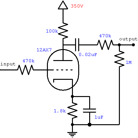

4) This isn't the only time a tube Big Muff has been produced. Check out this schematic.
Give me your thoughts fellas. probably gonna start ordering parts. Never soldered anything in my life, but this has me curious enough

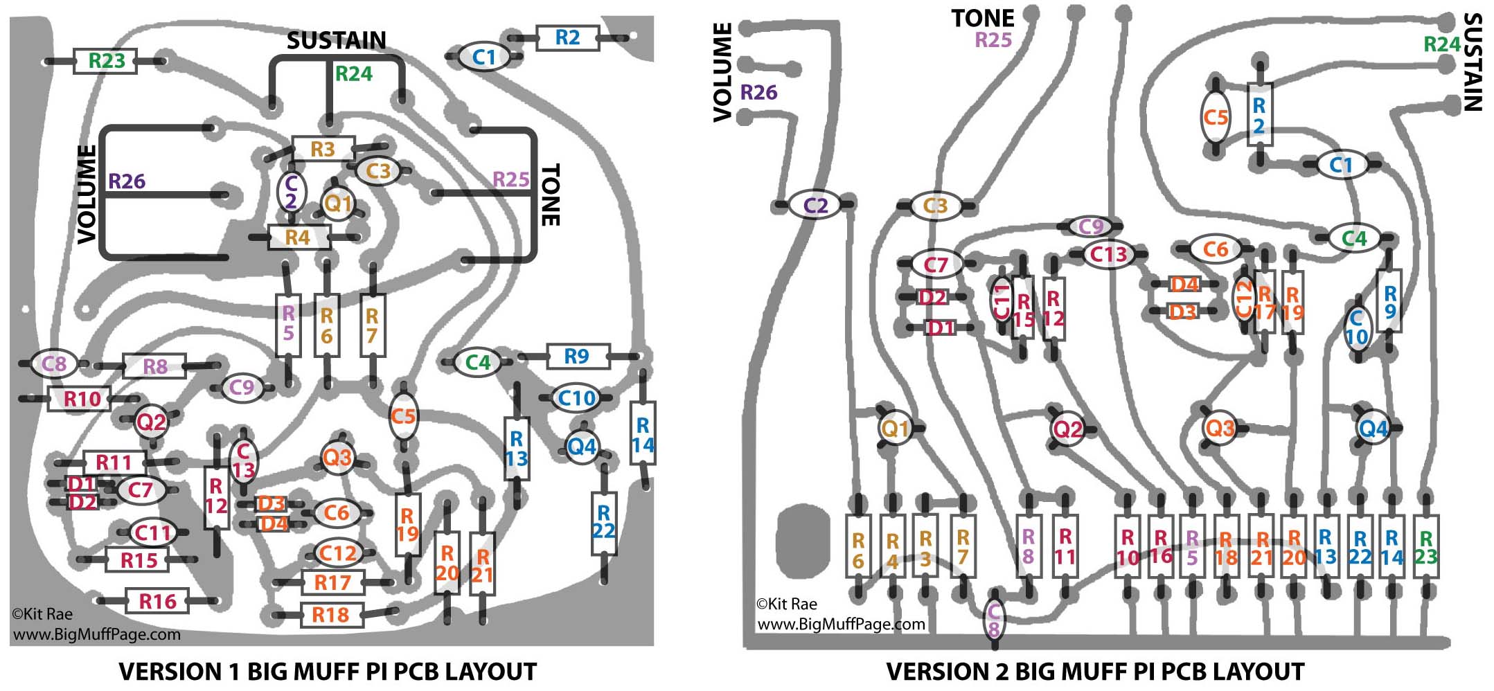

I agree that the red switch is a Diode/ECC switch. Also if you look at the "Bigger Muff" pic, you can see the same 2 diodes above Q3. I think they match the diodes in other pic I posted.  The 2 diodes that are supposed to be above Q2 maybe be hidden by a disc capacitor in the pic. So if the diodes are visible above Q3, then your 2nd dual gain stage theory would be correct, but that would also mean the switch is a "tube on/off" switch and not a "diode/tube swap" switch.  Also if this is a 250v tube gain stage, he must
have stepped down the voltage at the heater and then sent power to the board via the red wire. Here is a trace of the 76' BMP so you can see where he may have introduced the tube gain stage. Its ver 2 on the right:

The tone "switch" at the top of the board is actually a pot with the knob missing.
The tube stage is a typical high gain 12AX7 triode stage, similar to the one pictured here.
The power transformer on the right is supplying the B+, you will definitely need high voltage for this circuit to operate properly.      This is not a beginners first build!
It should be possible to use a nixie power supply or charge pump circuit to produce enough high voltage to safely run from a 9 or 12VDC supply.
You could substitute the triode stage for a valvecaster or fetzer valve, but where's the fun in that?

Thanks for joining the talk. Yes the tone knob is definitly a pot and the board is most likely a Rams Head BMP layout.
There are still a couple of mysteries though. The purpose of the red switch, and where does he introduce the tube gain stage. A few of us think at the q3 transistor clipping stage, this way it become a dual gain stage. Not a beginners build, and I am the detective in this whole thread. I've spoken to Richard and Ross Robinson before to get bits and pieces of info. There is one other person who has been in front of the pedal that may still be of help as well.

It could be a simple tube stage before the muff.  Something like reply 21 first tube stage with a cathode bypass cap something like 22uf.
I am still thinking the brown resistor on the perf board at a small angle could be dropping 12VDC to about 9VDC.
A good link for you http://www.aikenamps.com/index.php/designing-common-cathode-triode-amplifiers
An issue is the low input resistance of a BMP it is the about the 27K to 39K series input resistor you see on BMP schematics this loads the stage before and reduces the gain
So maybe both triodes are used in a 12a_7 or maybe  plate out to cathode follower
You could try a fet input opamp set to a gain of 10 with a 1meg input resistance before a BMP as a test, this might sound better.
