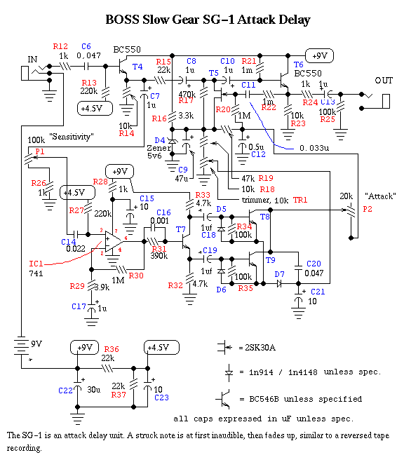

I'm planning on building a SG clone. The schem I got has all that buffer and latching thing I don't want to use since I'm going to true-bypass it.
Can anyone help me eleminating all that I will not be needing?
here's the schematic:
I suspect all the stuff beyond R11 can go off, but I'm not sure
Cheers!

I think you're right. It looks like you could just chop off the switching circuitry up to R11 and leave it at that. I'm guessing that T3 is off when the effect is on. If it's reversed from that, then all you would need to do would be to connect the wire running from the attack control to a 1K resistor and then two signal diodes like 1N4148 and then to ground, as to mimic the voltage drop across T3 and D3. That should do it.

I drew the original, I guess I can update the schem to pull out  the flipflop.

Should I consider pull down resistors on the in and output to eleminate pops when turning the thing on and off?
I see R25 on the output... Do I need to change it?[/i]
My pleasure. R25 is fine as it is. You can add between 1M and 4.7M to ground at the input on either side of R12 to get a reasonable pulldown there.

P2`s "southside" is still floating; is that OK?
QuoteP2`s "southside" is still floating; is that OK?
It's not floating; it's tied to the timing capacitor, where the variable resistance determines how fast the envelope detector T8/T9 pulls down the gate of the FET that's doing signal shunting.
The gate has to be pulled low to turn the shunting JFET off so signal goes though the main path.

Hi Jonas, I had a bit of time for this mod.
I've drawn and built the layout on GGG, so I applied the mods suggested by RG and Peter, so I simply removed R11 from the circuit and it works well, the effect is always engaged.

:? UPS!!  Just noticed that the pot I have for P2 is 22K, not 20K... What kind of trouble am I in?
smoguzbenjamin
Probably not much because most pots have a 10% tolerance anyway ;)

Quote from: Jonas:? UPS!!  Just noticed that the pot I have for P2 is 22K, not 20K... What kind of trouble am I in?
I'll get a longer delay in the attack when the pot is set for max resistance. Anyway, with 2k the difference is slightly audible...
