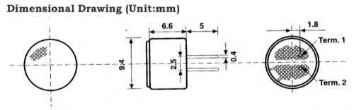

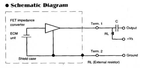

And   A "Better' condenser.
 I built some mics using a condenser element for about 4$ each.
 they actually work real good too.
 Getting the element for a cardoid mic is a very technical deal requiring alot of overhead to get started, I would say buy a Shure, or something decent, or try a condenser...really quite the performer...I've used it for recording and it works just fine.
