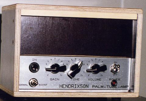

puretube
little OT, since not starved...
« Reply #6 on: May 08, 2004, 03:56:23 AM »
here`s a nice example of sticking a "Tube-Zipper" (2x 12AX7) into a different box, reduce the number of controls, throw in an EL84 to get 6W - pure-tube FX;
(HT, though...) :
the footprint of this little amp is exactly the size of Aspen Pittman`s "The Tube Amp Book" (4th ed., 1993, paperback), i.e. smaller than the E-H "diamond" boxes.
