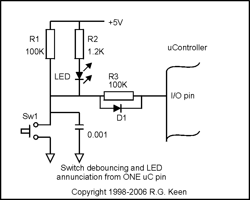

For those of you ready to stretch your programming muscles, I developed a circuit that uses the same PIC pin to both read a switch and control a switch-state LED - but with the same pin.
On my custom footswitchers, I use eight pins of a PIC to not only read the switch, it debounces the switch, and also leaves an LED attached to the same pin that reads the switch in the correct on/off status for what the switch state is inside the uC, which may not be the same state as the physical switch is at the moment. For instance, this can make momentary footswitches look like alternate action OR momentary OR sticky-switches OR one-of-N.
So, for extra credit - howzat work?

Close, but backwards.
The trick is that it's always an output - except when I want to see whether the switch is made or not. I blip it over to "input" for just long enough to tell if the switch is up or down, whether or not that's a bouncing up or down. The human eye can't tell if an LED is off for a few milliseconds.
I have a timer interrupt set for 10ms, and every timer tick, I go make all the switch pins be inputs by manipulating the data direction register, not the data holding register. That leaves what the controller thinks is the LED state alone in the data holding register, and lets me make the pins all be inputs. There is a mild RC on the switch, enough so that if the switch is not bouncing, it settles in under 100uS to the value it would be if the output happened to be in the wrong direction.
So when a timer tick happens, the pins are set to inputs, and I spend the next millisecond or so doing my math from the last timer tick. That math includes all of the record keeping and thinking about whether the switch is debounced, etc.  Then I read the pins, store what the pins read now, flip the data direction register back to all outputs, and resume from the interrupt. Now I have 9ms (or 90% of the available processor) to do whatever the processor was doing anyway. And that doesn't even have to be concentrated in 90% intervals, as the program never sees what happens in the interrupts.
Ah - but how does the program know if switches have changed? I set flag bytes while I'm in the interrupt level indicating the current state of the switches. The main loop just looks at the state of the switches as reflected in the flag bytes and manipulates things accordingly,  including turning the switch LEDs on and off. The switch polling routine doesn't know or care what the main loop is doing. I just rounds up data from the switches and sets the flags for "here's what's happing now".
However, this whole thing could easily enough be done without interrupts. You just put the interrupt code in line with the main loop and pad out the operations with a wait loop to use the other 80% of the time that nothing's happening.
Quote from: bioroidsWhat I dont understand is how you wire the "hardware" part: the switch and the led, together.
Ah. Yes, I spent about an entire afternoon on that one now that I think about it. The switch is pulled up by a resistor, and has a cap across it just to keep transients from being so wild. The pullup resistor is paralleled by an LED with a series resistor. The switch pulls the LED/resistor down when it makes. The processor pin has a parallel connected diode and resistor connected to the junction of the pullup resistor, the LED/resistor series, the switch and the cap to ground. When the uC pulls its output low, the diode to the switch contact lets the uC turn on the LED. When the uC pin is high, the resistor paralleled with the diode prevents the uC from being damaged when the switch is pressed.
When the uC opens the junction by turning into an input, the LED turns off unless the switch is pulled to ground.  If the switch is pulled to ground, then the LED turns on for the time the switch is closed even if it was set to "off". This is actually a good thing, because it shows the person that something is happening on the (presumably) footswitch. When the switch is released, the LED is controlled by whether the uC pin is high or low. When the uC pin is an input, since no current flows in the resistor, no voltage drop happens across the resistor and the uC pin senses whatever is happening at the switch.
Here's a schemo:
