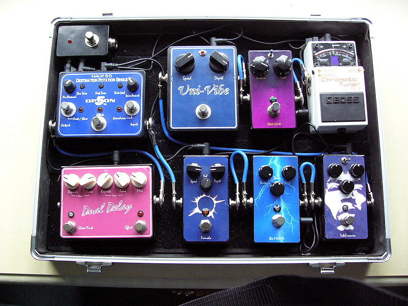

selectortone
Re: Let's see those pedalboards!!
« Reply #71 on: August 05, 2008, 06:54:07 AM »
Here's mine. The only non home-made ones now are the Boss tuner and the Option 5 Destination Rotation Single.
The little box in the top l/h corner is 9v distribution with on/off and a bit of filtering (supplied from a separate 9v 1.5A PSU I keep out of the way behind my amp)
The chain is TU-2>DynaComp/Janglebox>Uni-Vibe clone (re-housed/true-bypassed Dano Chicken Salad)>Tubescreamer/Lovepedal Eternity>Big Muff Pi >EA Tremolo>Option5>Rebote 2.5 Delay (with dual controls for a switchable slow and fast delay)
« Last Edit: August 05, 2008, 07:03:51 AM by selectortone »

DougH
« Reply #73 on: August 05, 2008, 07:08:04 AM »
Wow, beautiful work!
What is in your "janglebox" circuit?
"I can explain it to you, but I can't understand it for you."
selectortone
« Reply #74 on: August 05, 2008, 07:46:12 AM »
I got this mod from the site that isn't mentioned here.
The Janglebox is just a tweaked DynaComp - in a DynaComp the circuit adds hi frequency pre-emphasis before the CA3080 and de-emphasis after it as a way of minimising the noise inherent in the way this circuit works. To get the hi-frequency 'jangle' don't filter out the pre-emphasis after the op-amp.
Find the 150k resistor at the output of the CA 3080 and remove the capacitor which is connected in parallel (typically 1nF) to this resistor and bingo - instant jangle.
I've made that cap switchable on my pedal so I've got a standard DynaComp with it in the circuit and the bright setting of the Janglebox with it switched out.
My thanks go to Analogguru for this mod (and for all the other stuff he shares with us mere mortals).
edit: 'just a tweaked DynaComp' is a bit harsh - perhaps I should have said 'a novel take on CA3080-based compressor circuits'....
« Last Edit: August 05, 2008, 08:17:23 AM by selectortone »
