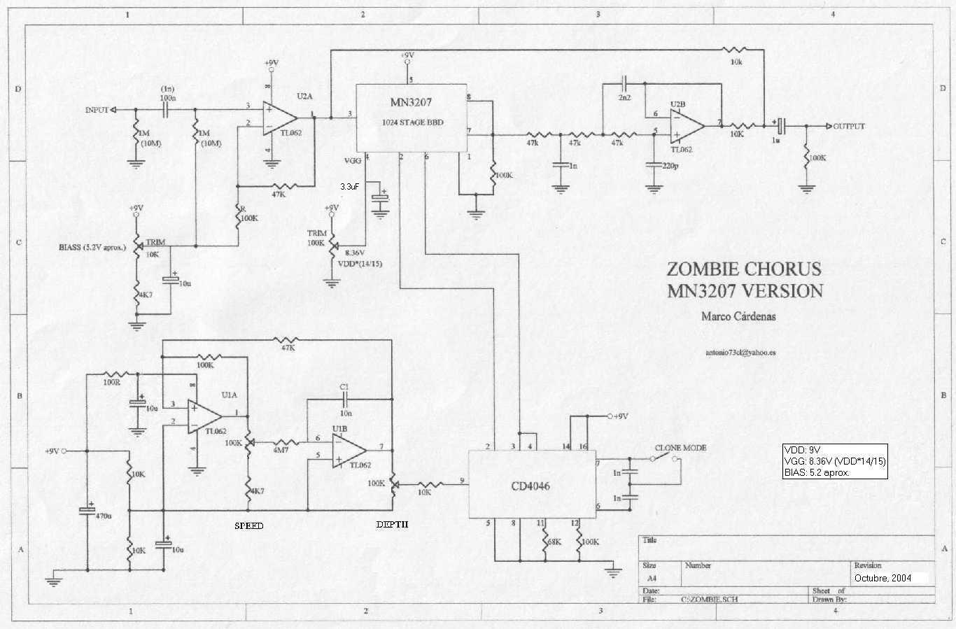

That last example is for a MN3001 but it shows the two biphase outputs which could be used for other BBDs if the clock is adjusted right, correct? So my question is, can I sub in an MN3207 for an MN3007 in the Ultra flanger if I adjust the power and ground pins and give in a 5V supply, without needed to adjust the clock input pins. Will I need to switch the clock input pins? Will I need to change the clock components since the MN3207 and MN3007 have different clocking capabilities?

In general, do the LFO and BBD need to be run at the same voltage? I've modded the FL301 to just use 9V since I don't need 12V for the MN3007. The LFO is run on 9V but the MN3207 wants ~5V. I've regulated the supply going to the BBD to 5V. Should I put the LFO at 5V as well or can it still run at full supply voltage?
How do I bias these circuits, the BBD, the Clock, the LFO, etc. All schematics I've looked at for different flangers and choruses all have different bias circuitry. What voltages am I trying to feed to these parts of the circuits in general for proper function. The datasheets don't give any info on biasing.
I've tried to use the MN3207 in the ultra flanger with no luck. I tried the circuit with the CD4046 pins 3/4 and 2 going to MN3207 pins 2 and 6 respectively through the CD404. Also tried it as it is in the schematic and no luck. I saw a schematic for the Zombie chorus adopted to use the MN3207 here, http://www.synthdiy.com/files/2007/zombie_chorus_mn3207_based.jpg. This runs CD4046 3/4 and 2 to MN3207 6 and 2, which is the opposite of the Ultra flanger. Do the pins really matter since the clock signal is just opposite phase between pins? In that zombie circuit the MN3207 is biased through the Vgg pin 4. Again I'm uncertain how I should bias all these cirucits.
Any other ideas about what needs to get what voltage and what bias?

Stephen thanks for that link, I see in the FL9 that the LFO and clock and BBD are all run at 5V. I'll try that out here...

Ok, successfully got the FL301 running with a BL3207/BL3102 combination.
The power supply is now +9V. I ran the LFO at +5V along with the Clock and BBD. I replaced some of the FL301 parts with the values from the FL9 schematic. For reference:
R149 - 200k
R148 - replace with 10uF capacitor
R147 - 220k
R146 - 150k
R144 - 8.2k
R143 - 10k
R142 - 27k
R114 - to ground
Very subtle flanger, its alright but not as intense as I want it to be.
Now to get the Ultra Flanger working....
