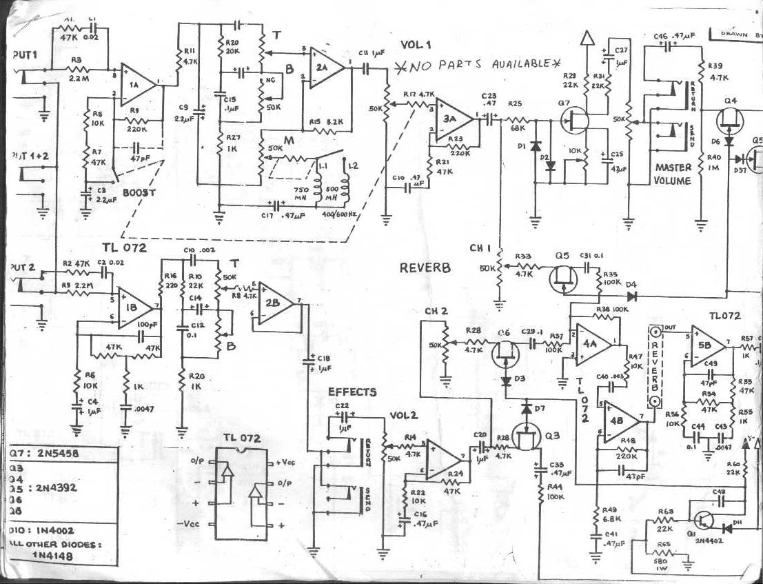

aron
QuoteOther than Mu/Syrrp circuits, I haven't had much luck getting Jfets to sound as good as other distortions types.
Interesting.
With very few exceptions, every circuit that I love and use has a JFET in it. Despite all the problems that have been stated, I have been able to get my "personal" circuits to sound quite good using trimmers and sometimes using fixed resistors. I use a well-worked variation of the Shaka live for years and I haven't used anything better than this circuit. No other circuit I have used has lasted this long for me. I have tried over and over to replace it with some other circuit, but the JFET rules for me.
I heard someone play my rig last night and my suspicions have been confirmed. I will leave the discussion on whether we should use them to others.
You see, that's the silly thing aron - OF COURSE we should use them. Use whatever works.
I had a friend named Albert that once said "Everything should be as simple as possible - but no simpler."
The Right Way is to learn what is and is not, what the variations are, and work with them.
aron
I just noticed that my Pignose 150R used a trimmer on the source for the FET stage. Interesting....
http://www.diystompboxes.com/amps/pignose150r/pn1.jpg
