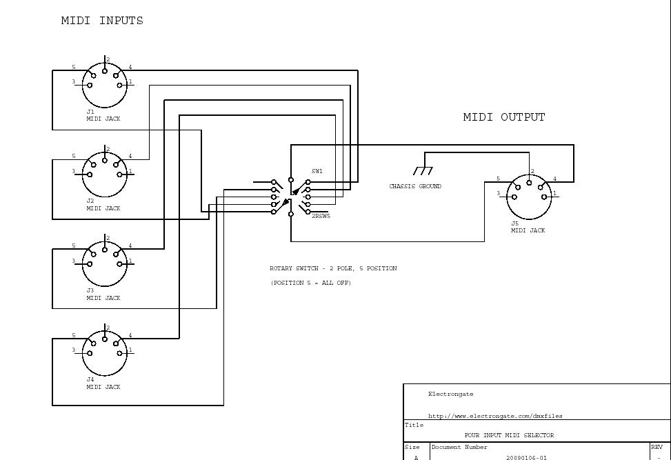

Hi everybody,
i have to build a midi router that selects one of 4 inputs: say, MIDI OUT from 4 synthesizers plugged in, a rotary switch to send one of them to the MIDI IN of an expander.
Now, do you think that an analog switch would be fine? I'm wondering if should i break grounds also, or if i could get them wired all the time without fearing of any ground loop.
Thank in advance,
D.

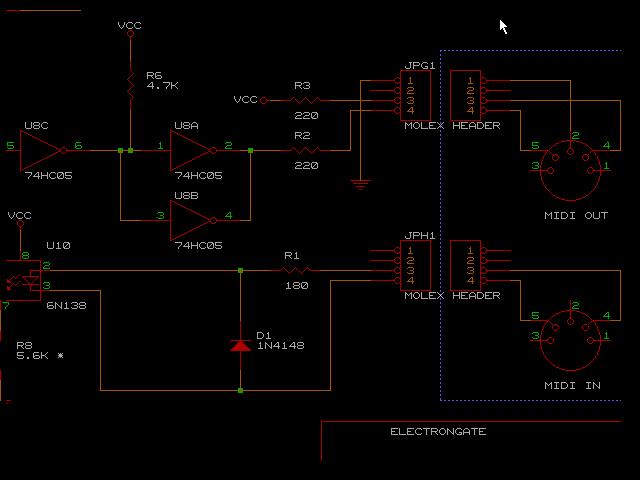

A MIDI connection is a current loop.  There is no "ground" connection on a MIDI input jack.  The ground connection on a MIDI output jack connects to the cable shield, which has no connection on the receiving end.
Here is a section of a schematic of a typical MIDI device showing the MIDI input and output sections.
Notice that there is no ground connection to either pin 4 or 5 on the input or output jacks.
Here is a schematic of a circuit like what you want.  You will need a two-pole switch.  This one uses a five position switch to provide for an "all off" position, though you could easily use a four position switch instead.
(This schematic is also available as a pdf here: http://www.electrongate.com/projects/stomp/MIDISW.pdf)

« Reply #7 on: January 06, 2009, 12:41:58 PM »
On your schematic the chassis and the shield on the midi out jack, though connected together, have no path to earth and are floating, and rather than helping keep noise out of the data cable will increase it, by being an antenna.  Like if you had an xlr cable with the shield disconnected at both ends, it'd be a noisy cable. By switching the ground with the +5 and data, you electrically recreate a long midi cable from the midi out of the synth to the midi in of the expander.  Your schematic does that, but the shield is broken and left floating halfway through the cable, if that makes sense.

Processaurus -- You are right about the floating ground.  I was going to make a note about this, but it slipped my mind.
You could either do away with the ground connection on the output and keep the output cable very short (this would be my preferred solution), or choose one of the input jacks and connect the shield pin through to the output shield pin.

« Reply #11 on: January 07, 2009, 02:20:53 AM »
Not idiot proof (you'd always want to use jack w/ the connected ground) but that's an interesting solution.  I'd personally still lean toward the 3p4t ground switching way and never have to worry about it, but if the switch wasn't handy and a 2p4t was, sure.  The "all off" setting is a handy idea too, for a 5th position on the switch.
