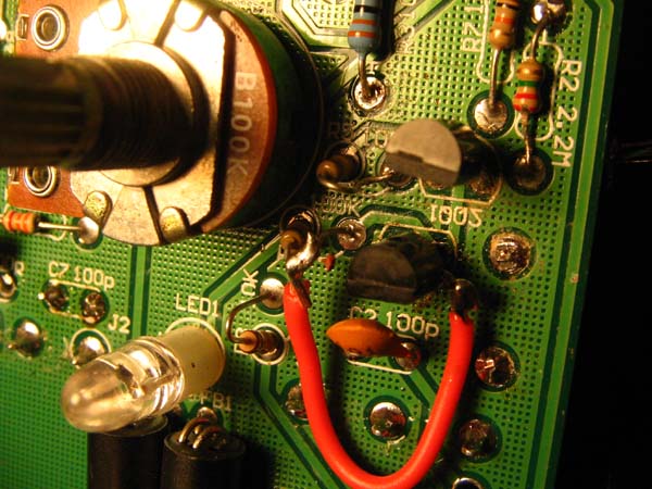

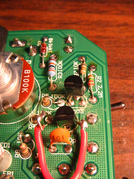

I've been meaning to make a post about those Nano Muffs for awhile but just haven't had a chance. The reason that they sound like crap is that Q1(the transistor closest to the footswitch if I remember correctly) is upside down. The transistor symbol on the board is wrong so the emitter and collector are reversed. Sounds much better once you flip it around.
Alan
MoltenVoltage
I flipped around Q1 and it has more bite, but it's also more nasal.
The mark for Q2 is actually a mirror image as well.  I think they did it to fit the text for both Q1 and Q2 near each other.  Q1 is definitely backwards based on a typical NPN transistor installation - the collector was grounded rather than the emitter.

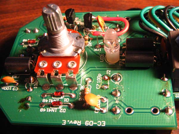

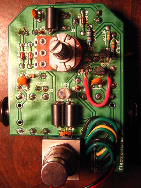

Here are the gut shots.
I changed the output cap [C7] from .0001 to .002 uF and it got rid of the harsh high end that shows up if you run it after a compressor
This shows Q1 flipped around:

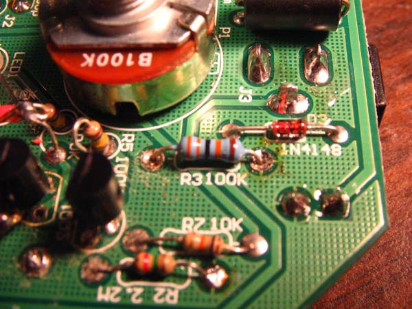

This shows the [R3] 100K resistor change (looks like I ended up using 330K):
Here you can see Q2 is printed mirror image and Q1 is upside down on the silk screen:
(the red jumper is because I fried a trace)

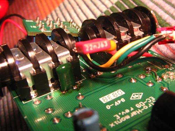

I ended up having to rewire the switch because the cable shredded after taking it out of the enclosure 3 times:
This shows the two input caps and switch:
In all its glory ::)
It sounds decent now and gets two very distinct sounds with the input cap switch.
