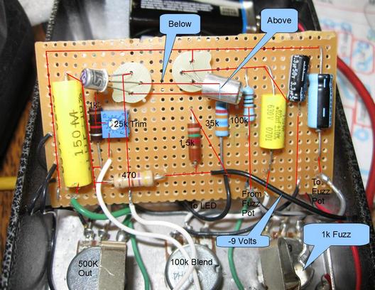

Here's a picture of the board of my not an easy face fuzz
Thanks Again for your comments

interesting, nice picture. looks like you have a silicon at q2 and ge at q1. did you try it the other way around ( the way i usually like it )?
sounds like you found the problem, a messed up pot.
my fave combo for easyface is 2k/47 uf to ground at q2(ge)emitter, 25 k trim to set bias @ q2, 250k input gain control pot, no fuzzpot, maybe even a 75k feedback resistor in place of the 100k.
if the tranny is good on q2, it sounds pretty nice.

« Reply #6 on: March 10, 2010, 06:08:55 AM »
Cool suggestions
Right now I really like the smooth sustain with the ge in Q1 and the hi gain si in Q2. I will have to take another listen to the si in Q1 and the ge in Q2
I am going to try a 2k fuzz pot and see how it sounds.
