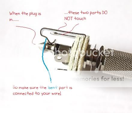

Also, I just noticed the picture of your output jack. It's a switched jack - when you plug your cable in, the tip of the cable pushes 'bent' part of the jack contact away from the 'straight' part. Take a look and you'll see that the tip of the cable only touches the bent part. You need to make sure that you have soldered your wire to the lug that is connected to this. Sorry again if this is obvious and you've already checked it.
Hope that makes some sense. I can't get to my PC, otherwise I'd add some notes to your picture to make things more clear.

Well thanks again Mark Smiley , but I've re-checked everything already a hundred times and I still have no clue what's wrong with it..
Also, the 'straight' and the 'bent' part are connected, and I've checked it with my meter by touching the bent part with one tip and then touching one of the two connection points with the other, and in both of them the meter beeped, so I assume it does not matter where I connect my cables between those two... (So I can switch and nothing will change..)
Do you have any more suggestions? Could something be broken?
yes, they do make contact when the plug is out, as soon as you plug in the plug the "straight" short metal is disconnected from the "bent" one, so, of the two connection ponts, now only one is making contact with the "bent" one. Put a new, unconnected plug into she jack and them meter the contacts... that's the easy way to check which is which.
best of luck.... you'll get it woking, I know I already said this but.... no one f...ing ckt can stay in a "non-working" status for long in this forum!!!!   Wink Cheesy Grin
