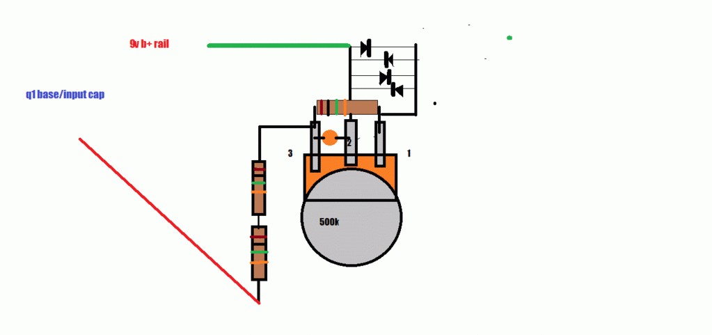

« Reply #13 on: April 15, 2012, 02:02:08 PM »
dino,
if ya haven't boxed it yet, try adding this thing in and see if you like it.
i call it a bias clipper cuz it's kinda what it does.  will let you completely change the contour and sound of the distortion from very buzzy like a bronx cheer buzz, to the jawari thing, and smooth right on up to full tilt fuzz. i used 105k resistors when i built this, and the 220k i specified is really just the two 105k's in series. 10pf on the cap, you can build the whole thing on the back of the pot.
really opens up the sound options of the fuzz. i'd start with the fuzz up full, and the bias clipper off...then slowly turn it up and see what the controls do. the controls  become hyper-interactive with each other, but you can crank it full blast and then just adjust it with the add on circuit alone. it's cool, bro, and if ya don't like it, well, nothing ventured nothing gained.
but i think you'll diggit...:
i used a combo of 1n34 and 1n34a's for the diodes...different kinds of casings.
the 105k EDIT: RESISTOR, NOT CAP goes across the 500k linear pot. the 10p cap goes between pin 3 and wiper of pot, diode clipper connects between wiper and pin 1.
add 220k or thereabouts of resistance from pin 3 of the pot, and hook that to the junction of base and the input cap in parallel on q1.
connect B+ to the wiper. it will let you bend and warp the distortion at will...i think it's a worthy addition.
not sure what it does, but i think it feeds square waves back into it that are heavily clipped and rectified from the diodes, and with the original signal being the source, after being amplified by the transistor...feedback loop or something?
it also seems to brown out the pedal. can get nice pwm kinda fuzz, all the way up to like gary moore kinda ooooooohs. buzz to fuzz. try it, and let me know what ya think.
i'ma gonna go shoot one of dem stupid pedal tricks right now...

pinkjimiphoton
Posts: 3608
"it's got YOY" jimi in manchvegas
WWW
Re: Burnski Buzzaroundski
« Reply #14 on: April 15, 2012, 03:02:45 PM »
dino and brothers...
here's a quick cheezy demo of the bias clipper in this circuit.
sometimes it sounds like it's gargling, it's cool. check it out. you could even put it on a switch! Wink
<a href="http://www.youtube.com/watch?v=58pKhpmIChE" target="_blank">http://www.youtube.com/watch?v=58pKhpmIChE</a>
synthy, mouthy, funky, fuzzy, lo fi, screaming bizzarro octave fuzz and a whole lot more!!!
this is just the pedal, two cords, a cheezy guitar and a cheezy amp!
