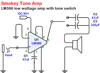

Just add a cap to ..say, pin-5 of the TDA7052, in the same manner that you would do it with a 386 chipamp. 47uF would be more than enough, perhaps 10-22uF would be better.
Say, like here (but do it with the TDA7052 in the Punch amplifier):
http://www.beavisaudio.com/projects/NoisyCricket/oldpics/SmokeyTone.gif
Instead of a speaker, connect a resistor (or a pot), say 1K ..or even 10K, and this is going to be your "cd-out". You will most likely have to pad it down, since it's going to be too hot for a cd-input, so using a potentiometer instead of a simple resistor wold be even better idea.
Simple enough?
