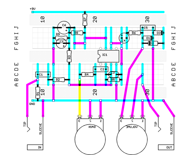

Layout
Here is a plan for our breadboard layout and a photograph of a partial layout:
You can see the IC in both with pin 1 in column 21 and row E. R7 is at the top in column 18. C6 (the large black electrolytic capacitor) and C7 (the smaller blue electrolytic) are also plain to see, but R9 is hidden beneath C7. By the way, you don't have to follow my postitions exactly as long as you make the same connections. If you run into trouble, perhaps then you should pull everything apart and try to reproduce my build exactly.
On the map there are thick pink lines that represent jumpers. These are shown in the photograph as red, yellow, orange, and gray jumper wires. The color coding of the jumpers corresponds to premade lengths that you can buy. Cutting your own is just as good.
On the map there are also thick blue vertical lines that represent connections available in the breadboard. Five adjacent holes in the same numbered column are connected. To give an example, look at column 18 for rows G, H, I, and J. In the diagram, R7, R8, and two pink jumpers connect together through the blue vertical line for those rows of column 18. You can see the same arrangement in the photograph. R7 has one lead stuck into J18 (row J and column 18). That lead is connected to the lead of R8 that is in I18, and the yellow jumper lead in H18, and the red jumper lead in G18.
The thick blue horizontal lines along the top and bottom of the map are power rails. We are going to use the top one, marked with a red line on the actual breadboard, for +9V from a battery. We are going to use the bottom one, marked with a blue line on the actual breadboard for ground. So R7 is also connected to +9V. One of the leads of C7 is connected to ground, because the two orange jumpers beneath C7 in the photograph connect to the ground rail through row 12.
Unlike the other groups of 5 holes, the power rails are connected horizontally across the rows of 5 holes. So, in the photograph, R7 is connected to the hook up wire that is stuck into the first power rail hole in the upper left-hand corner.
Note: On some breadboards, these power rails only run for half of the board and you need to put in jumpers if you want to connect them all the way across.
