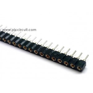

To mount transistors buy a row of SIP sockets (pictured) and cut off a row of three.
