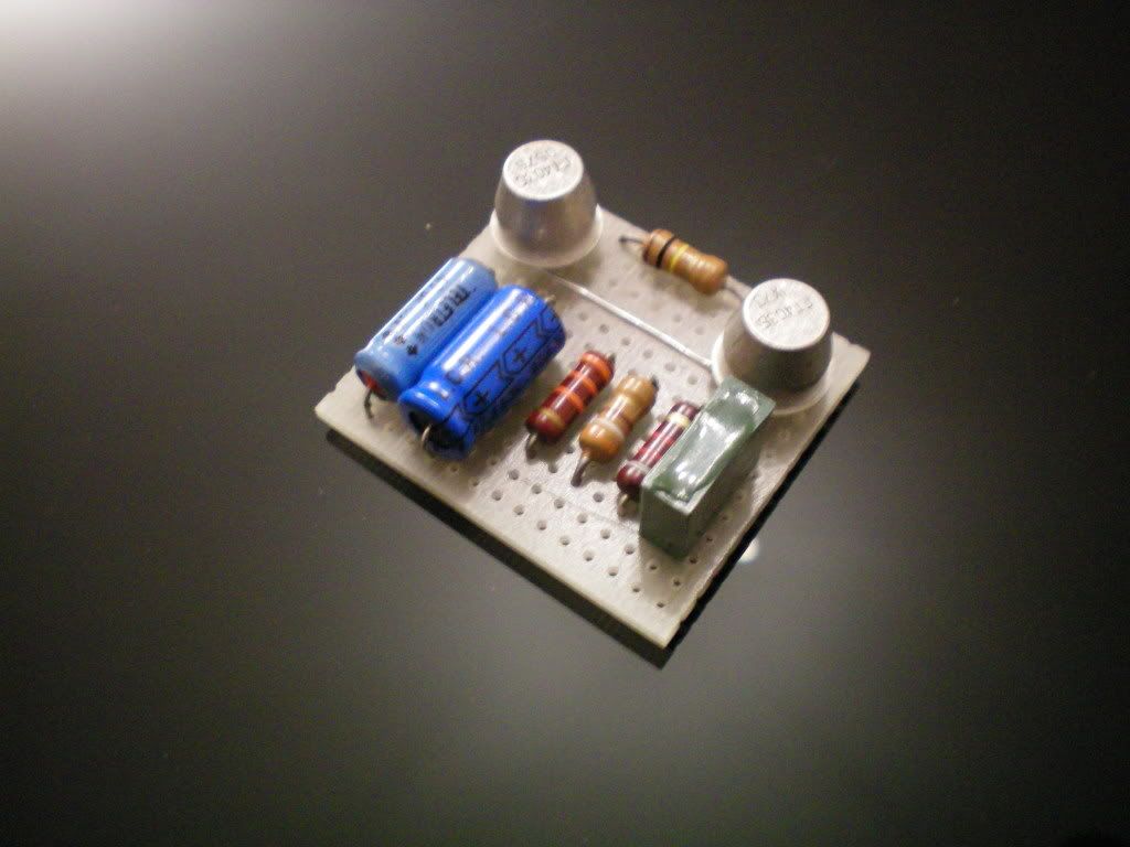

And solder them in last.  Get the resistors, caps and leads all done, then put in the transistors.  Can tin the holes if you want, but as said I usually just do a lead at a time with a cool down period.
I soldered these Ge suckers with no problemo:
