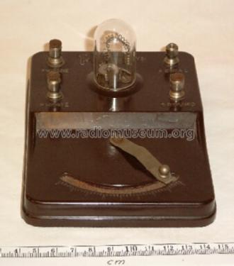

Here's a classic galena detector with variable arm position to find the best point:
This used to be a standard for crystal radios.  As well as these, Philmore used to make crystal radios with the cat's whisker contact already placed in the best position and sealed under a glass dome:
This gives you a better view of the dome:
