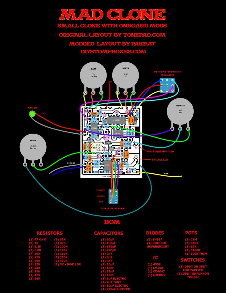

After many marathon building sessions, I have completed my entry..... finally!
Name of entrant: pakrat
Pedal name: Mad Clone
Tell us a bit about the pedal: It's a Tonepad Small Clone with a bunch of mods found in the build reports and on the internet. The mods required a lot of extra wires and switch mounted components making the build messy and tedious, so I decided to make a new pcb with all of the mods board mounted. This is not a new layout, it's Francisco's layout from Tonepad with a few additions.
The mods allow a pretty wide range of sounds over a the standard Small Clone.... they include flanger, tremolo, regen control, and vibrato. The toggle switch changes it from chorus to vibrato, and also has a dry setting if you want the tremolo by itself. To be fair, I should note that this pedal suffers from the volume drop many others have reported, and traditional "fixes" did not work because of the tremolo mod. I believe the LDR is responsible but didn't have any others in stock to experiment.
The box is finished in yellow powdercoat, full faced waterslide decal, and powder coat clear on top. I have never worked with powder coat prior to this and it proved to be very difficult to get the clear to evenly cover the decal without pin holes or other problems. I had to strip the box to bare metal and start over six or seven times before I got it, but in the end I'm happy with the results.

Layout:
Pcb:
Schematic: Fransisco's schem with mods added. Don't laugh if it's wrong, I've never drawn a schematic before....
References:
www.tonepad.com
http://beckyjc.wordpress.com/pedal-builds/small-clone-mods/
http://experimentalistsanonymous.com/board/index.php?topic=1578.0
Special thanks to JOK3RX for helping me with tracing the original pcb!
Special thanks to Fransisco at Tonepad for this, and all of his other great projects!

@paktat
AWESOME build bro! I love it!
Been thinking about building another Small Clone and I really like what you have done and what you have added to the project.
A BIG THANK YOU for the transfer. I like to do PnP and I am definitely gonna get this etched very soon  :icon_cool:
Couple questions...
As for your volume drop issue... Didn't Rob find a solution for this on his clone? Can it be implemented here?
Second... Where is the stereo mod?  :icon_wink: Do the mods not allow the stereo output OR was it a matter of space?
EXCELLENT WORK!!!

Thank you Gov! I did try ALL of the fixes for the volume drop and none were effective. If I cover the LDR the level goes up, so that leads me to believe the light/dark value of the LDR is either wrong, or my part was mislabeled. I do have the pdf files of the layout and pcb but I didn't have a dropbox acct to post them. I could email them to you if you want. Volume drop or not, the pedal sounds great and the crappy audio on my vid does it no justice. The tremolo works very well and the vibrato is also much better sounding than you would think, being an add-on.
pakrat
Re: **The DIYStompboxes 10-Year Anniversary Contest Thread**
« Reply #557 on: August 31, 2013, 02:46:00 PM »
Oh yeah, the stereo mod.... I didn't include it in my build because I didn't really need it. The pads are on the pcb so you can still build the stereo version.
