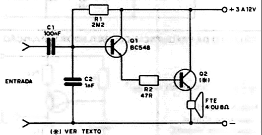

There are a bunch of similar projects out there, but they usually have only one speaker at the emitter of the power tranny:
She/they since August 2021
tca

Any power amp which runs _DC_ through the speaker and has more than 3 parts is a dubious thing.
Running DC through the speaker heats it up (wasting power capacity) and makes the coil sit off-center in the gap (wasting bass excursion).
Back in the 1960s we did do such tricks, but with a lot fewer parts, because parts were eXpensive. (Like 3 hours wages for one power transistor.) Parts are now cheap and you can do a better (less speaker abuse) amp with just a few more parts.
These all have dubious bias arrangements. Even the trimmable one will go-out as it heats. "Simples Alplificador de 3W" could be biased better with fewer parts.
Of course if you just like messing-around, and don't mind occasional smoke, go for it.

I tried that last one, with the TIP31 (used a 2N3055 tho), and it didn't do much to impress...quieter than an LM386 with no gain cap....probably should've used the right transistors, ha ha...I noted the DC at speaker, didn't think that was too cool...
