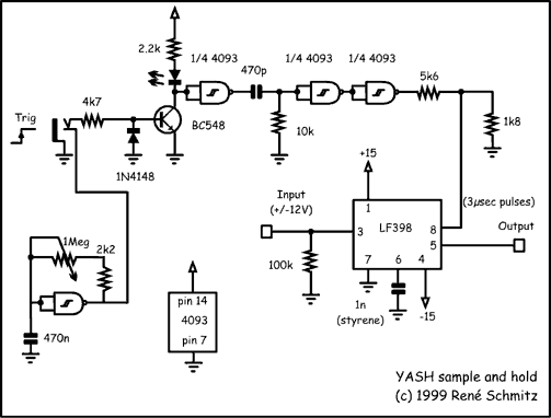

I've been interested in incorporating the sample/hold angle into my Infinitphase for a while now, so I've been breadboarding for a couple of days now. Mike, over at Prophesysound, was cool enough to point me towards what they've used in the original units, so that's what I've been futzing with. Everything shown below is running off the +/-15v of the Infinitphase, and on the breadboard, I'm using another LED to see the output of the s/h.
The s/h section is LF398 based, lifted from Rene Schmitz page;
The noise source, Mike recommended is this one;
So far, I've managed to get it working, but not as it's drawn. This has me wondering if I'm doing something wrong. In the s/h section the (I'm assuming) rate LED, just above the BC548, would blink, but not in an on/off fashion. It was more of a bright/less bright type of deal. I decided to take the lead above the 2K2 resistor from the +15v, and switched it to ground, and now I have a truly blinking LED. Why does the diagram show connection to +15v?
Another thing, the 10K resistor, just after the 470p cap in the s/h. Using it where it is drawn, kills the s/h output (output LED stops flashing). For fun, I moved it to before the cap. The s/h seems to work, but judging by the output LED, the best result seems to be without the resistor installed at all. Why?
Have I done something wrong here, or am I on the right track? I mean, it seems to work right now, but not as drawn.

It sounds like you're doing something wrong around the BC548.  The LED can't flash with the 2k2 connected to ground because the emmiter is also connected to ground so there's no where for any current to come from. My guess would be that you've connected the emmiter to -15V instead of ground. Maybe the same thing with the 10k?

Dang!...
The power supply of the Infinitphase is actually +15/0/-15. I'm using the 0 as ground, rather than the case ground. Could this be the problem?
I'll recheck my power connections. Bizarre though, that the LED is flashing normally.  :icon_rolleyes:
The 2K2 is connected to V+, not ground??
Re: Re:
« Reply #4 on: February 17, 2015, 08:28:56 AM »
It's supposed to be, Dino said he connected it to ground though.

Friggin' hell!!! I have the LED flipped around.  :icon_evil: I guess I needed you guess to grill me a bit to open my eyes. Thanks!  :icon_wink:
In any case the LED flashes the way I would want it to flash now, that's to say completely on/ completely off. The other way it only slightly dims in intensity as it cycles.
This is what is on the board right now (with flipped LED).
The 10K resistor is out, it's a real killjoy. The noise source works as advertised, and I'm getting really nice randomness on my output LED. Video anyone? I can shoot a quick clip if anyone is interested.
EDIT: Maybe the 2K2 needs to be adjusted for the LED to flash properly the other way? Gain of the transistor at play? Tried it, didn't work. My modified drawing works.
grilled digit? what would (the other) DA say about that?
yr diagram still shows the 2k2 to ground, tho. how does the led forward bias?
[edit :] and isn't that nand following the 470p effectively an un-terminated/un-pulled input?

What he said, that shouldn't work, the 4093 shouldn't be doing anything with it wired up like that either. Something in what you've built doesn't match what you've drawn, or something funky is happening that's putting some Voltage on the inputs of the the 4093 and the collector of the BC548. What voltages do you measure on the transistor pins?

OK OK OK.....
I'm a dumb-ass. I had, for some unbeknownst reason, stuck a jumper in between pin 4 and 5 on the 4093.  :icon_redface:
Everything works as it should, and all is right in the universe, no thanks to me.
Thank you for bearing with me folks.
