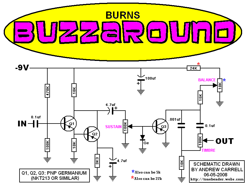

OK, some really bad noob questions now (sorry!!!)
Firstly, as I've never used tagboard before, which are the OUPUT and INPUT lugs on the board?
Secondly, I'd been using this diagram as reference....
....but didn't notice the 6-pin footswitch. How straightforward is it to wire in a 3PDT switch?
Also, the 3 lugs on the jack sockets. What's the SLEEVE, RING, TIP order for them?

OK. This image already incorporated shielded wire, the core in blue, and the shield in gray.
If you look at this schematic, you should be able to figure out which end is which...
The 6 pin switch is essentially 2/3 of a 9 pin version. Refer to the previous example image that I posted before. You'll use the third section for the LED alone (leaving one pin free).
If the blue wire is your core wire, and grey is your shield, then where the blue lines connect are the tips, with the shields going to the sleeves. The ring (red wire) is used on the input jack for switching. (There you go, just gave you another hint as to where to find the input on the board. Trace away! :icon_biggrin:)
Cool. I was hoping this was the case.
Ha! Thanks.
I've been trying to ignore the shielding part of the 2 core wire (which is essentially grounding every part of the pedal, it seems) and concentrate on the core wire. It looks more busy & complicated than it actually is.
I'll put my Sherlock Holmes hat on later & see if I can suss this out. I'll be drawing a new diagram (which I'll post) that I can refer to when I wire this thing up.

OK, how's this looking?
(I think I might've got the LED part wrong).....
EDIT - On second thoughts, I could've got a fair bit wrong. I copied across all the wiring from the 6-pin diagram, including the jumper which is positioned differently on the 3DPT switch you've referenced. Man this is a headache! I tried to have a go with the schematic but I just don't understand them.

Editing the original diagram might explain how I was thinking (effectively adding an extra vertical row of lugs to make up the 9 pins....
Was I right, close or nowhere near?

Looks good to me.  :icon_cool:
