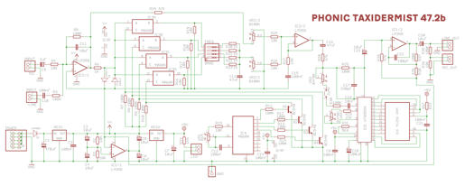

Ring modulators always caught my attention somehow and I've got really good results with the Phonic Taxidermist (Maplin Voice Vandal) circuit which is basically a CD4060 oscillator feeding choppers. More or less a high frequency tremolo. Modulating the frequency control gives some really cool ring mod sounds.
Now what is the XR2206 doing different?
I understand the circuit above is in sine wave mode due to the closed connection of pin 13 and 14. Ring mods seem to prever sine waves but what waveform exactly does the CD4060 put out?
There's no external switch to chop the input signal, so what happens between input and output of the XR2206?
Thanks a lot!
EDIT: here's my Phonic Taxidermist ring mod schematic:
http://www.mediafire.com/convkey/f0ce/pg8xvrd884sdgae4g.jpg
Thanks for help
~arph
#2
Yes, that's the one.  the beauty here is that the XR2206 is the function generator and multiplier rolled into one IC.
A lot of other sine wave ring mods use two chips for this.. eg. a LM13700 and an AD633
What the XR is doing is multiplying the generated sine wave with the incoming guitar signal.
Mr. Lime
Ahhh, thanks for the clarification!
So there's a significant difference between multiplying and chopping waveforms.
How about chopping the already multiplied "ring modish" output signal?
The infamous Lovetone Ring Stinger is multiplying the guitar signal with a carrier signal formed by a VCO which is modulated by a LFO.
Modulating the frequency of the XR2206 with an LFO should work fine but is the XR2206 capable for a triangular carrier signal just by breaking the connection of pin 14/13?
