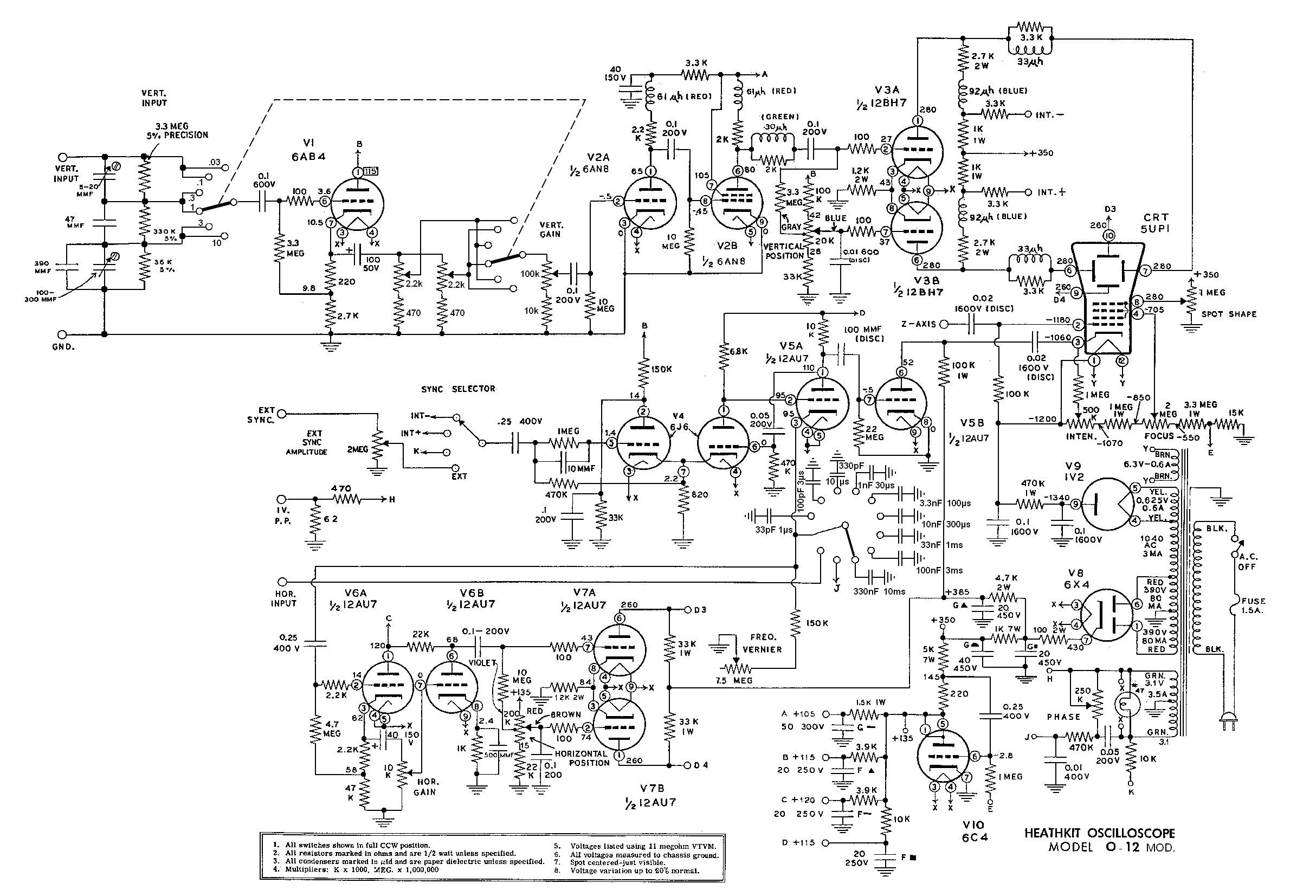

ok replaced the 1v2 tube. no line on scope tried all settings. what should I look for now.
the only tube i could not test was the 6af
Schmatic

OK we don't know  if there's a problem with the HV (~1200V) or not.
Don't put your meter across the 1200V it will get zapped.   There's a trick to measure this but normally you don't have to measure it.  It is often checked by measuring current by measuring the voltage across R62.  Don't worry for now deal with that later.
There's many things to go wrong and it only takes one to stuff it up.
So it's best to go through each section one by one.
For reference:
http://steptorun.com/shop/icon/2/EX-3-0022.jpg
Power:
- Are the heaters on all the tubes lighting-up?  (Including the Display you should see a glow at the back of the tube.)    Can't remember if you can see the heater working on 1v2 or not.
- Check all DC power rails
Check Horizontal amps:
- Switch the sweep selector to Horizontal input  (EXT on the Sweep Selector *NOT* the Sync Control).
-  Measure the voltages on the plates of V6A and V6B.
   Check the  the Horizontal Position makes the voltage go up and down on each.
   When one plate goes up the other should goes down and the two voltages should be
   more or less equal with the Horizontal Position roughly in the mid position.
Check Vertical amps:
- Set the Vertical Sensitivity to 50V
- Measure the voltages on the plates V2A and V2B
   Check the  the Vertical Position makes the voltage go up and down on each.
   more or less equal with the Vertical  Position roughly in the mid position.
-  Wouldn't hurt to check plate voltages on V1A, V1B, V1C
[EDIT:
FYI:  With the Horizontal mode set as above you will no longer get a line.  You will get a dot which you can move up/down left/right with the Vertical and Horizontal position controls.
Don't let the dot stay in one spot it will damage the screen.   Keep the intensity down on this mode so you can just see it.   Only turn up the intensity while trying to find the dot.

The manual in the other thread was for the transistor version (unless I've missed something).
Here's a link to a tube version which is similar but not the same (eg. V1 is split into V1 and V2).
Until I find an exact match it can be used as a guide.  The main point is it has some test voltages marked on it.  They should be a good ball park to get you started.
http://www.heathkit.nu/O-12_mod_schematic_2428.png
Non-mod version:
https://elektrotanya.com/heathkit_o12_oscilloscope_sch.pdf/download.html
https://elektrotanya.com/PREVIEWS/38933510/23432455/heathkit/heathkit_o12_oscilloscope_sch.pdf_1.png
« Last Edit: October 11, 2018, 05:55:42 PM by Rob Strand »

ok they are marked. meter set on 600
v6A  69 pin 1
v6b   32  pin 6
They do not move when switch is moved
v2 a   65   pin1
v2b    45   pin6
dose not move with switch

They look low.  Should be 260V and 280V.
Have a look at the Heathkit schematics I posted a few posts ago (reply #5).
They have voltages marked on the schematic.
Start by measuring the voltages in the bottom right hand corner of the schematic.
They have  labels A, B, C etc.
These ones are probably the most important to check at the moment:
G_semicircle  +350V
G_triangle  +385V
G_square   approx +430V
Then,
A +105V
B +110V
C +120V
D +115V
Actually the Heathkit circuit is a little different.  Here's my best guess at the voltages:
Use the caps and the resistors on the supply to help you find them on the actual unit.  When you measure the voltages make sure you measure the correct side of the resistor.
« Last Edit: October 11, 2018, 09:42:35 PM by Rob Strand »

I've annotated your previous pic with the voltage points and some part values.
To me it looks like C33C and C33D are swapped on the built version; assuming we go A, B, C, D
counter-clockwise on the caps. (I'm just mentioning that. It is how it is drawn in my pic and it's fine like that.)
Give me a chance to look over your new pics.
