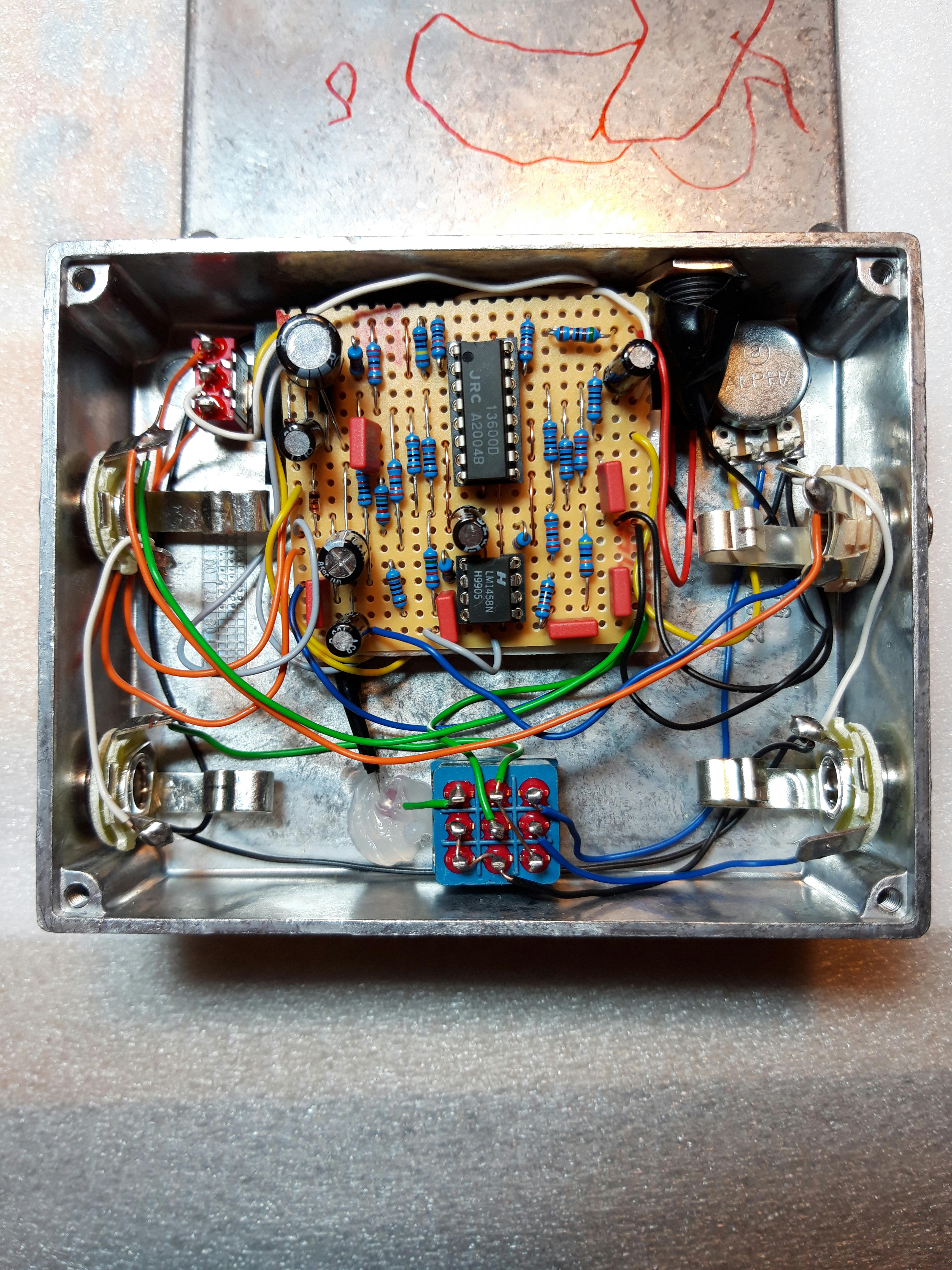

I built it using the tagboard layout. I always thought it was accurate, but these update... we whould track it again! :o Or maybe update the schematic reading all the information we can read in that page GGBB linked us.

And just to make the topic even clearer I can say that I built this:
https://3.bp.blogspot.com/-imI0JcQ_gSI/VAmT8yw-f3I/AAAAAAAAImM/MqxVruF6nCo/s1600/Paul%2BCochrane%2BTimmy%2BRev%2B2.png
Definitely the Treble and Bass pot work better if they are audio tape. Indeed, I ordered for a mistake two linear, but I could use just the first 30% about. And both the pots work like a "filter": you got max bass and max treble with the pots at minimum.
I have to look better the page you linked.
Then I built even the Jan Ray:
https://4.bp.blogspot.com/-Kl8c9Ob6p3g/U-vrtT1wGFI/AAAAAAAAIdI/JUibz5iBxD8/s1600/Vemuram%2BJan%2BRay%2BRev3.png
The layout wasn't exactly this, but Bass e Treble pots work commonly, indeed, they are connected differently from the Timmy layout.

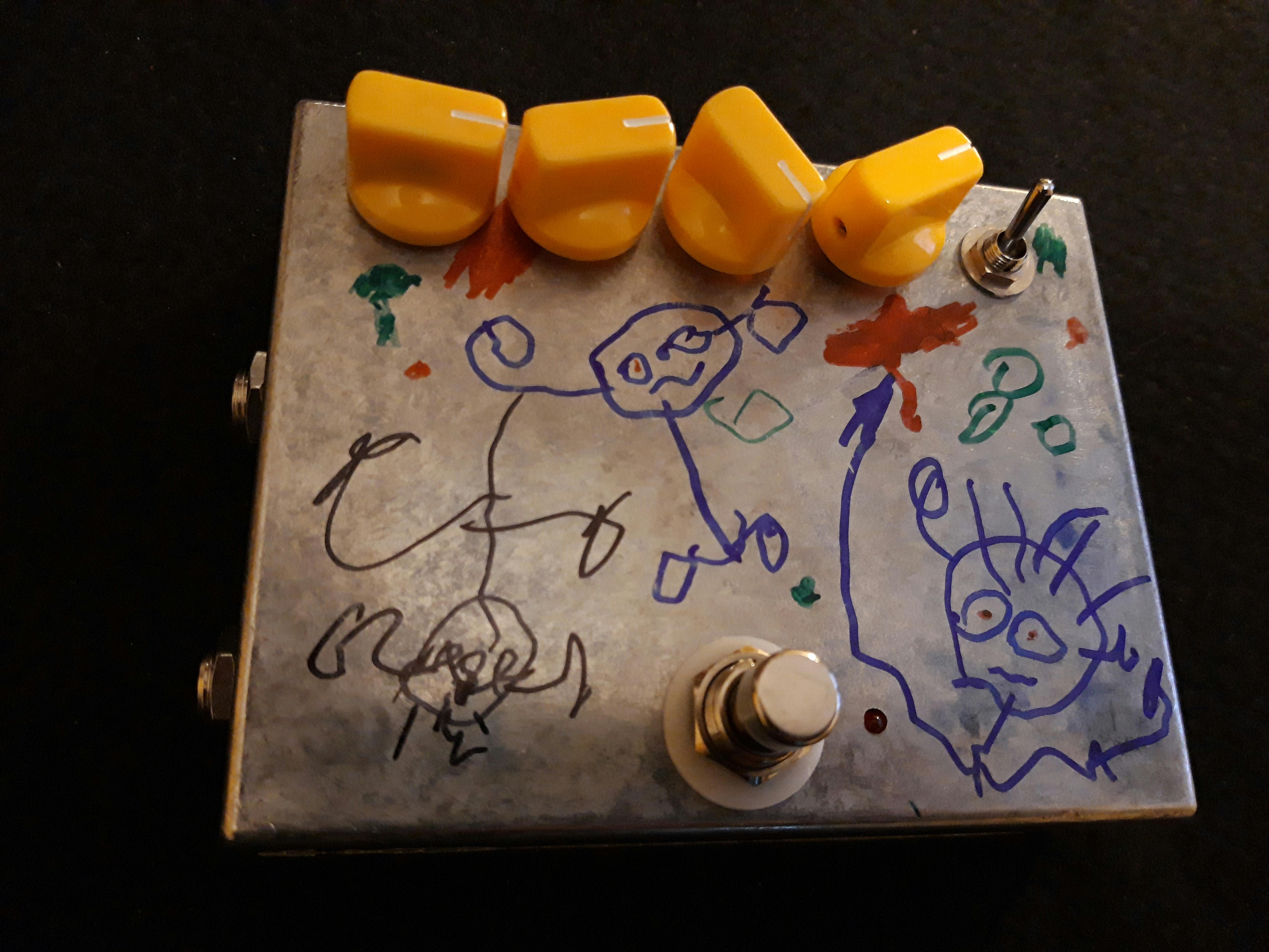

BTW the dude in my pic is the real Tim (according to PaulC).
