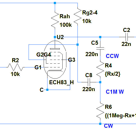

If you don't need it to overdrive, the tonestack will not make any harm.
jhsa
True. I need it to boost the signal a bit, and color it nicely, that's it :)
João
#62
I've been writing to Mr. Derk Reefman, who is one of the guys behind utracer (http://www.dos4ever.com/uTracer3/uTracer3_pag14.html). I was initially asking him about various params for remote cutoff pentode and heptode modelling, and during that discussion, I've sent him a schematic for this preamp. He noted that G3 shall be connected to ground, or to cathode potential (to conserve tube and extend it's life), and not to anode or even worse B+. My question is why? I don't have a book covering heptode, so I must admit my knowledge on this topic is really poor.
At LOW voltage, <12V, I would not worry about it.
And specifically the ECH83... the datasheet says "as RF or IF amplifier" Vg2+g3+g4 can be run at full supply voltage. See also graphs G H I.
