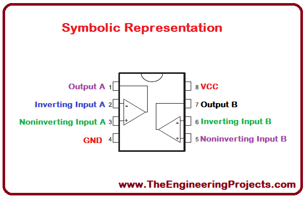

Why do they use NJM2904 and NJM4558? What's the difference between the two? They look very similar to me.
diffeq
Quote from: rankot on April 06, 2020, 05:59:50 AM
NJM2904 is LM358 under another name - it can pull all the way down to the negative rail, which is used for level indication comparator. Red led would always be lit otherwise. The 4558 is picked for less noise than LM358, I assume.
