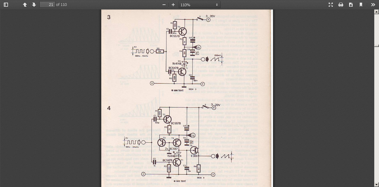

anotherjim
Quote from: ElectricDruid on July 23, 2020, 06:48:06 PM
Quote from: anotherjim on July 23, 2020, 04:46:39 PM
Following a link elsewhere led to this...
https://worldradiohistory.com/UK/Elektor/80s/Elektor-301Circuits-79-179.pdf
Circuit 101 on p19 of the pdf.
Yep, basic integrator. Same problem - amplitude goes down as frequency goes up.
I guess the title of circuit #101 (it is the 101st circuit, not using 101 as a beginner class metaphor!) is misleading - it is claiming constant amplitude output of a sawtooth from a square input of variable frequency.
Quote from: anotherjim on July 24, 2020, 03:47:31 AM
Sorry, I was too hasty and didn't read all the way through. Yes, it has the same fundamental problem, but those circuits have compensated it. That's clever, and if it works as well as they say it does, it'd be pretty impressive.
We're still a good way from a sine wave though. Our poor guitar signal needs turning into a pure square wave (comparator fuzz style, and ideally with 50% duty cycle) then feeding into this circuit, then the output from this need rectifying to make a triangle wave, and then that triangle wave needs wave shaping using a OTA overdrive or similar to make an approximated sine wave. Phew!
Well, I guess it *might* work, but to me that seems like a lot of steps where something can go wrong.

Quote>> ..  it is claiming constant amplitude output of a sawtooth from a square input of variable frequency.
> .. those circuits have compensated it. That's clever, and if it works as well as they say it does...
There is a dynamic response waveform at the end which suggests it will always bobble.
Converting arbitrary waves to sines is trivial in un-real time. Listen, tune your MOOG or HP200AB knob. You can contrive a digital demon to do this, off-line. The problem is doing it "live" without sea-sick pitch.
