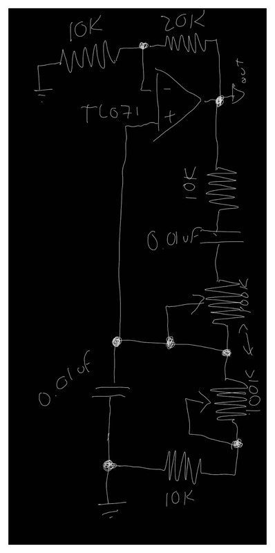

I first thought of trying it with an Arduino, which I have more than a couple in stock, but I could only get a square wave out of those without buying extra parts,s o I decided to keep the Arduino out (I have to admit, the OLED screen telling you the frequency is pretty cool, though!).  I also looked at options with the 555 timer, but those make selecting a frequency kind of a hazzle.  I also made a quick breadboard with a Wein bridge oscillator using a dual gang pot with a TL071, but that did not work as expected (I am getting nothing if I connected to a small amp).  Just in case anyone is interested in educating me as to why that did not work, though, here is what I did with that:
Please excuse the horrible schematic and hand writing; I did that on my phone!
The reason it didn't work is your circuit needs a +V and -V supply with grounds connected to 0V.   To get a single supply versions running you need to bias the opamp.
The simplest case is to only bias the RC network like this,
For a 9V supply Vref needs to be 1.5V.    You can use same circuit for Vref that's used on pedals only the resistors aren't the same value.    So 10k from Vref to 9V, 2.2k from Vref to ground then at least 10uF from Vref to ground.
Another way is to run both the ground connections back to a Vref which is set to Vcc/2, exactly the same as you would do with a pedal,  maybe use a 47uF Vref cap for this one,
For your circuit the 50k + 5k + diode is just the 20k resistor.
In this circuit the 5k will sort of set the output level.   The way of adjusting the output doesn't give as clean a output as you you might want.   If you tweak the 20k you might be able to get a cleaner output.
The oscillator you built is a Wein Bridge.    It's has good frequency adjustment but needs the ganged pot.  The output can be clean with more complicated designs like Merlin's but  it is possible to get a cleaner waveform from a simple circuit like yours by tweaking the 20k resistor (too low and it won't oscillate too high and the output is distorted.)  Don't try to use the 20k to adjust the level.  Keep the output high.
RG's circuits are Twin-T oscillators.   They are very simple circuits and they don't have any problems working.    The output isn't as clean as the Wein but it is certainly good enough for something that is more or less sine output.
The oscillator you built is a Wein Bridge.    It's has good frequency adjustment but needs to ganged pot.  The output can be clean with more complicated designs like Merlin's but  it is possible to get a cleaner waveform from a simple circuit like yours by tweaking the 20k resistor (too low and it won't oscillate too high and the output is distorted.)  Don't try to use the 20k to adjust the level.  Keep the output high.
OK, in mine the 2 100K pots are ganged (I drew an arrow trying to indicate that, but it barely shows!), so I guess I am on the right track then, with the exception of the ground I drew at the bottom (RC network).  Instead I need to connect that to a 1.5V source.  I take it a simple voltage divider adjusted to drop from 9V to 1.5V will suffice, right?
Yes it should bring it to life.    The 10k + 2k2 values should prevent any weird behaviour but really you need to add the bypass cap, say 10uF, across the 2k2.   Without the cap the divider will affect the oscillator.

Thanks, that worked perfectly.  In fact, even without the cap it works fine, but I left it in just in case.
Good news.   Yes it probably works without the cap but you might see subtle changes in the signal quality at low and high frequencies.  If you adjust the 20k too finely it could even stop oscillating at one end of the frequency range.    All finer points.   With the bypass cap in place it's much more robust.
