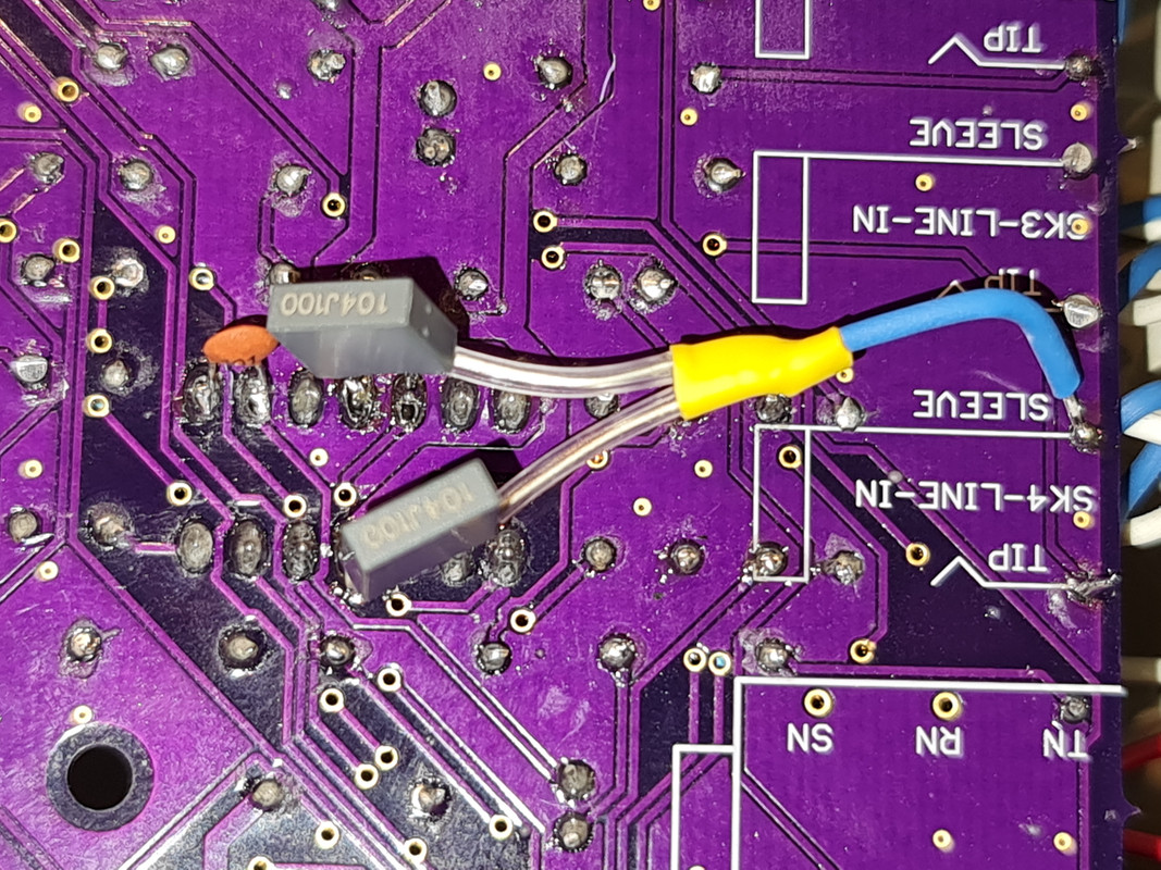

OK, put the 100pF cap in:
Put the IC back in.  This is what I get (no signal):
IC5 Pin 9: -12.5V
IC5 Pin 10: 140mV to -11.83V (depending on RV6)
IC5 Pin 12: -5.67V
IC5 Pin 13: -4.11V
IC5 Pin 14: -12.65V
I also think the bypass switch may be backwards, so I tried with the switch in the opposite direction just to be sure, but it makes no difference.  Tried it also with another new IC, but no change.
With no IC, pins 12, 13 and 14 have about 1.1mV each.  Where the heck is that V- coming from???  AAAAHHHH!!!!  I even thought maybe there was something making a connection only when the legs of the IC were in the socket, so I measured with a lead inserted in the socket, but no change...
OK, looking at the schematic, pin 9 and pin 14 have R68 and 69 touching them.  But without the IC in, both are in the single digit mV range, so the -12V is not coming from there.  I don't get it!
I build.  I fix.  I fix again.  And again.  And yet again.  (sometimes again once more).  Then I have something that works! (Most of the time!).

OK, I did this:
That is what you meant, right?  With that, I get these voltages:
RV6 Pin 2 @ -12.04
No Signal
IC5 Pin 1: Oscillating between +0.33V and +0.4V
D3 Anode: Oscillating between +0.62V and +0.71V
D4 Cathode: Oscillating between +0.47V and +0.22V
D3 Cathode: +3.80V
D4 Anode: -5.65V
Pin 14: -12.87V
Yes.  Maybe better if the ground point was near pin 3, close to the chip.
It doesn't look like it has done anything to fix it.
Wait a bit until I can catch-up reading your last two posts more thoroughly.
jfrabat
Quote from: Rob Strand on October 02, 2020, 10:50:28 PM

Soldered all the wires for the jacks last night.  The jacks I will install when it is ready for the bix, as these wires are a bit stiff, and they can break from handling (single core; only kind I have that fits the PCB hole).  I have to check if I have enough switches, though.  Still need to wire all the pots.  I will do that today.
