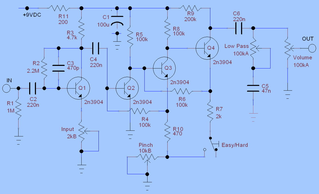

Hi there,
this is my first post here. And I am quite new at this too, building stomp boxes for about half a year and some change. I have encountered a problem that surely has a simple and elegant solution, but I was unable to find it on the internet. Building a Shoe Pixel clone now and it gives an unpleasant hi-pitched noise from the power supply (it is fine with battery), especially when the guitar is muted. Adding a simple power filter with diodes and capacitors helps a bit, but there is a significant drop of voltage I would like to avoid.
My idea is that if there was a simple and functioning circuit that would do the job, I would add one to every similar stomp box I make. I plan to build personalised stomp boxes for my friends and band members, as a gift or as thanks for something... and they, being punks they are, usually don't have a fine filtered power supply, so this would be a great solution.
And... I don't know if it's even worth mentioning, but don't be overly technical please. I teach humanities and I've rarely encountered electrical engineering before. I learned a lot from building my first pedals, but I am an absolute newbie nevertheless :)
Thank you very much!

It's a multidimensional problem.  You need to pin down what you are dealing with.
There's switch-mode vs transformer based supplies.  Different problems arise with each and different solutions are require for noise issues.
Wiring and the presence of on-board DC/DC converters and charge-pumps are another factor.
Based on the whine and the circuit I'm assuming:
- low current pedal
- switch-mode power supply.
A switch-mode power supply can produce whine if the load is too small.   This can happen when powering a low-current pedal.   It would be wrong, and solving the wrong problem, if the power supply is whining due to light loads and you are trying to patch it-up by filtering the DC.   The solution here is to put a dummy load on the power supply.  A load of 1/10th supply rating is a good start but you should definitely try to back off the load as much as possible.
Assuming it's not that then it is likely the HF ripple on the supply is too high.   That can occur on old PSU's that are about to fail.  Assuming it's not that then a DC filter can work.   For the lowest voltage drop a LC filter using an inductor and cap would work.
This came-up a few months ago.
https://www.diystompboxes.com/smfforum/index.php?topic=125422.msg1194134#msg1194134
LC filters have low voltage drop at DC.   Lower than RC filters.
An LC filter on the PSU will help stop noise from the PSU getting to all devices connected to it.   A local RC filter (or LC filter) in the pedal can fend-off some degree of noise from the PSU.   If you power multiple effects from the same supply, filtering the PSU is better because you know that's the cause of the problem.

This caught my attention! It is true that this whine appears only sometimes on some circuits! Haha... and I just realised that when I daisychain my reverb pedal with this effect, whining stops!!! So I think you nailed it :) Even with no load here the whine appears only in the "soft mode" that is lighter and has in fact a large volume drop from the "hard mode" (it was designed by Shoe this way).
So my question is sort of daring... but of the most importance for me in this post so I underline it :) ... forget the filtering for a minute... how could I tweak this effect to make it a bit more current consuming? Ideally to make the effect in "soft mode" louder (a unity with "hard mode" would be swell!) I will experiment with values, but I would like to know with which value I can experiment, and what I need to change here. I've already built it so I would need to know the parts, so would anybody be so helpful to look on it and tell me?

QuoteThis caught my attention! It is true that this whine appears only sometimes on some circuits! Haha... and I just realised that when I daisychain my reverb pedal with this effect, whining stops!!! So I think you nailed it :) Even with no load here the whine appears only in the "soft mode" that is lighter and has in fact a large volume drop from the "hard mode" (it was designed by Shoe this way).
You probably have both types of noise.
QuoteSo my question is sort of daring... but of the most importance for me in this post so I underline it :) ... forget the filtering for a minute... how could I tweak this effect to make it a bit more current consuming? Ideally to make the effect in "soft mode" louder (a unity with "hard mode" would be swell!) I will experiment with values, but I would like to know with which value I can experiment, and what I need to change here. I've already built it so I would need to know the parts, so would anybody be so helpful to look on it and tell me?
You could do it.   Where the jack enters the pedal just put a resistor across the incoming jack terminals.
I guess the problem with that is if you had 5 low power effects that need to pull a reasonable amount of power, the wasted power starts to add up.  Better is to make a dummy load which has a DC jack with a resistor.   You plug the supply into that load at the start of your daisy chained power.  That way there's only one load which you can easily tuned and has no impact on any of the pedals.
If you were going to make a filter which filters all the power then you could build a filter box and put the dummy load in that box as well as the filter.

always nicer when the poster provides the info, layout, circuit dia, but hey-ho. here, see, your layout and "A" circuit. the cap shown on the circuit diagram as C1 is in the wrong place on the parts layout, and won't work against the 200R resistor as a filter as intended. you can amend your layout by shifting the C1 leg currently going to the +9V line down to the row with the 200R and 200k resistor attached.
shift that cap, let us know if it works, and also welcome to the forum.

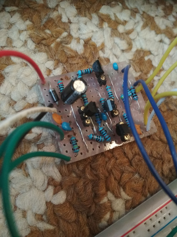

Sorry for not posting pictures and thank you for providing them! I did the thing you mentioned... but changed 100 uF to 470 uF just to be sure. The result is that it works pretty much as advertised :) There is still some noise in easy mode when Pinch knob is up, but it is comparable to other pedals I own... and hard mode and now even lower values of pitch on easy mode are without any noise whatsoever, the effect does good job cutting out everything, be it from pickups or source.
The squeal that was loud before is still here, but so quiet it doesn't matter, it doesn't bleed into signal anymore... and I am pretty sure that it has everything to do with the fact I use switch-mode power supply.
Here it is how it looks now. This vero is pretty messy, because I didn't get right values of resistors and now it is pretty hard to get anything, because my country ordered a curfew. There are three resistors instead of one in one case :D
