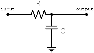

Does anyone have ideas for how to find and eliminate loud popping I get when bypassing or engaging the following?

I suspect the current pulses when operating the latching bypass relay is being "felt" in the audio path probably via the power supply routing. If you want someone to solve it, it might be worth showing the PCB routing.

Relays have all the same issues as true bypass switching, and add the new issues of power supply glitches, ground glitches, and coil voltage coupling. Magnetic coupling of coil current pulses is theoretically possible, but I've never encountered it.
The current to and from the coil can cause voltage blips on the power supply and ground. Attack this by making a local power/ground domain for the relay only. Put a local decoupling cap of ~100uF to 220uF as physically and PCB-trace-wise close to the relay and driver transistors as you can put them, and isolating the capacitor from the rest of the power in the pedal with a "refill" resistor. This resistor/cap should be the place where PCB traces from the rest of the pedal touch the local relay power/ground traces. This forces all the current from the relay coil switching to be satisfied from the local cap, not the rest of the pedal power supply. The exact PCB traces to/from the relay coil domain matter - a lot.
The refill cap should really be as big as you can bring yourself to make it. The refill resistor is much bigger than you would use to decouple a general power voltage. It's fine if the relay cap voltage drops a lot when the coil pulse happens. I size them so the decoupling cap refills in about 50-100ms. Humans can't really operate a footswitch faster than 20 times a second, so the cap is filled back up and ready for the next human action. Using a slow refill and a local decoupling loop may fix your issue entirely.
Capacitive coupling of the coil voltage to the audio path is solved by using a better relay. The internal construction determines how much of the coil voltage edges couple to the contacts.
Your circuit will allow you to run your relay from a higher voltage than 3.3V, as you're using transistors to fire the coils. The lower the coil voltage on a given relay, the more current the coil pulls and the worse the power supply/ground glitches will be. Use a relay with a coil rated for the incoming pedal power voltage. If you have 9V, use it for the relay.
Second, relays vary a lot in how much the volts-size coil signal couple to the contacts. Your input signal runs right through the relay, and worse yet, the input path impedance is up in the megohm range, the worst possible combination for coupling coil glitches. Use relays specifically rated as low-signal relays. Some low-signal relays have an internal shield around the contacts to keep coil glitches out. Use them if it's economically feasible. If you can't use shielded-coil relays, try different brands. Different internal construction matters in how big a glitch you get from the coil.

Quote from: R.G. on November 05, 2021, 11:40:53 AM
Can you point me in the right direction to learn more about the "refill" resistor? I don't think I'm understanding where to put it or what it's for.

If you look at R20 it provides a ground path for C1.   C2 does not have a permanent ground path.  It needs it's own equivalent of  "R20".   I suspect this is causing the pops.   You can wire the resistor to the top side of R20 (instead of ground) if you like to prevent additional input loading.

Quote from: Rob Strand on November 29, 2021, 05:42:01 PM
So something like the following? And any tips on sizing those R13 and R14's? I chose 1M as arbitrarily large.
That makes a lot of sense. But I did a quick test with a 1M from C2 to GND but no change in sound.
