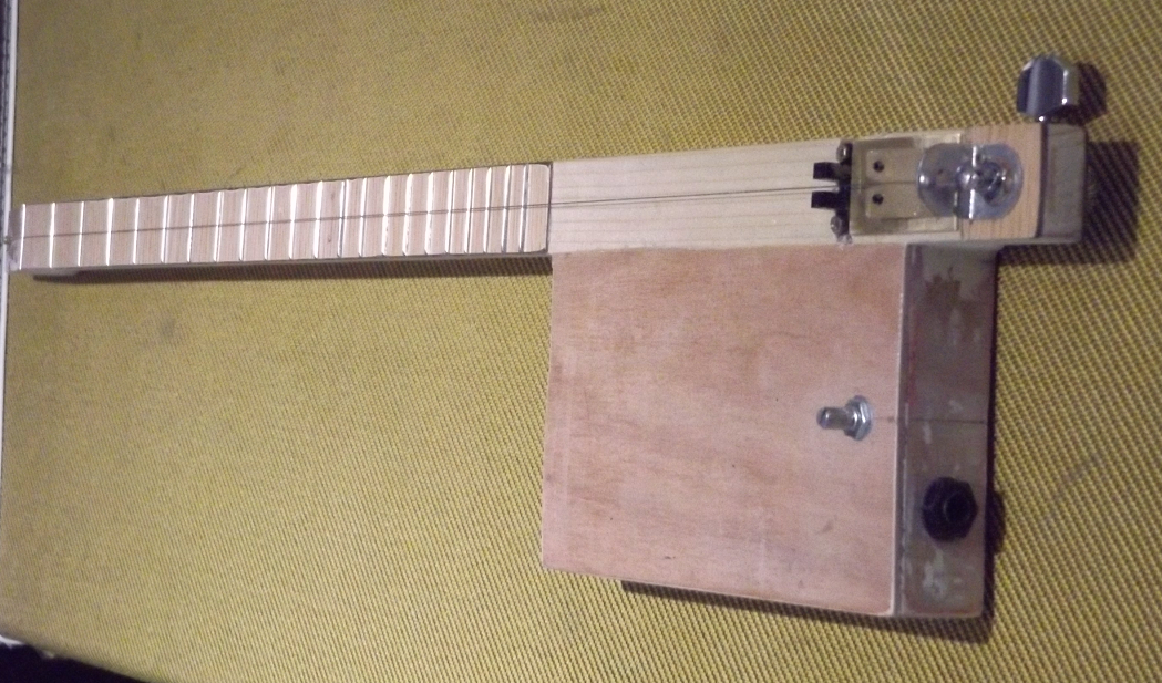

MkII stick now has frets (and a zero-fret, no nut), an adjustable brass bridge and the original interrupter Opto - easier to mount for one & height adjustable in normal pickup fashion. Oh and a basic plywood box on the side to house the electrics.
I put a plain G string on it this time. Remember it didn't look like this Opto can see thin strings so I expected I'd have to put a bit of sleeving over the string where it passes thru the Opto gap. Blow me, it works anyway as it is! Have sound and is pretty clear too. I'm not sure about the physics of this - it even seems to have a wider working area in the Opto gap.

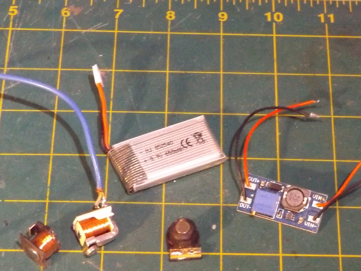

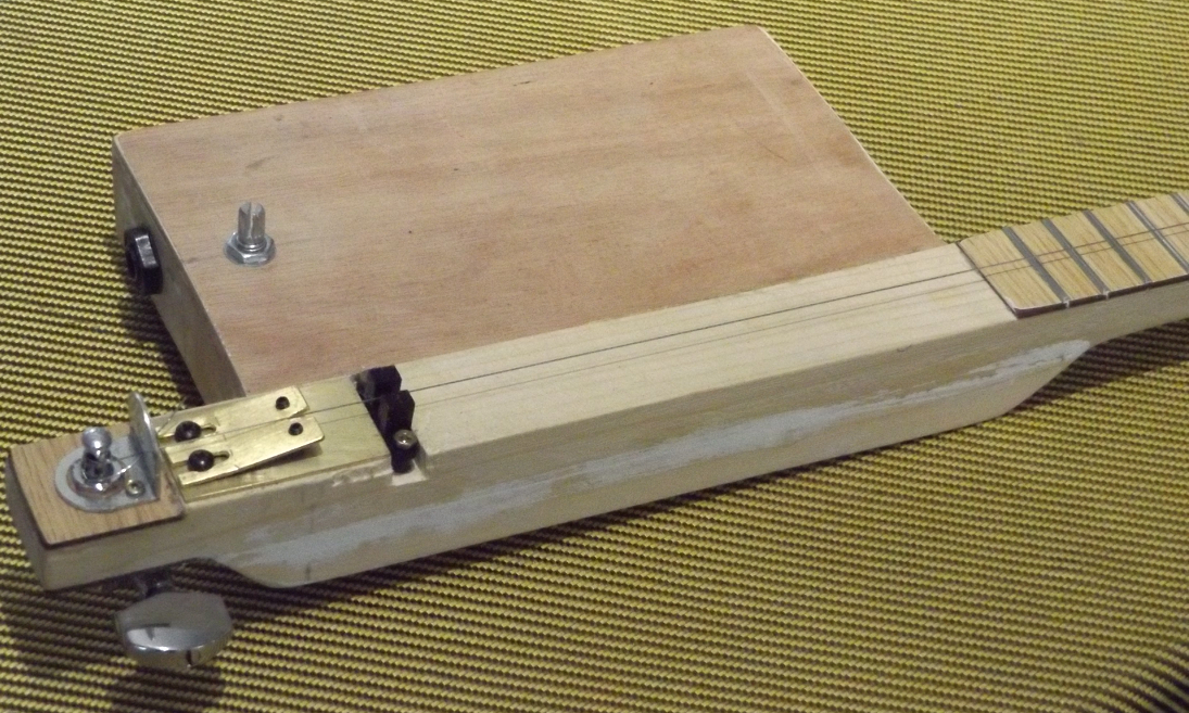

Since I've been asked nicely and although it meant finding some glass plates and flash powder, here are some exposures...
The last one is a selection of bits including some electromagnets from relays. The one in the middle was my original choice from a 6v SPDT relay with a less prepared example at the far left. The larger one with the cable is what I hope to use now and it's from a 6v DPDT relay. Also a LiPo cell and a DC-DC boost converter module.
I've started to make fit the control bits.
I put the tuner at the heel end, there's just a peg on the headstock for the string ball end. The steel angle device between the tuner peg and bridge has a sideways guide slot for the string to make sure it passes the centreline of the saddle and winds on low enough to keep the string tension down on the saddle.

The Guity Gurdy is alive. No demo recordings yet.
It got an onboard USB charger for the battery.
I found the sustainer works without a permanent magnet. The coil is under a cupronickel plate. The opto sensor got an alu' cover to keep the sun out.
Fret markers exist as white dots along the upper edge of the fingerboard.
The green blob is the battery test button.
I like to think that the rectangular box is an accidental nod to Bo Diddly -  because, Diddly Bow!
