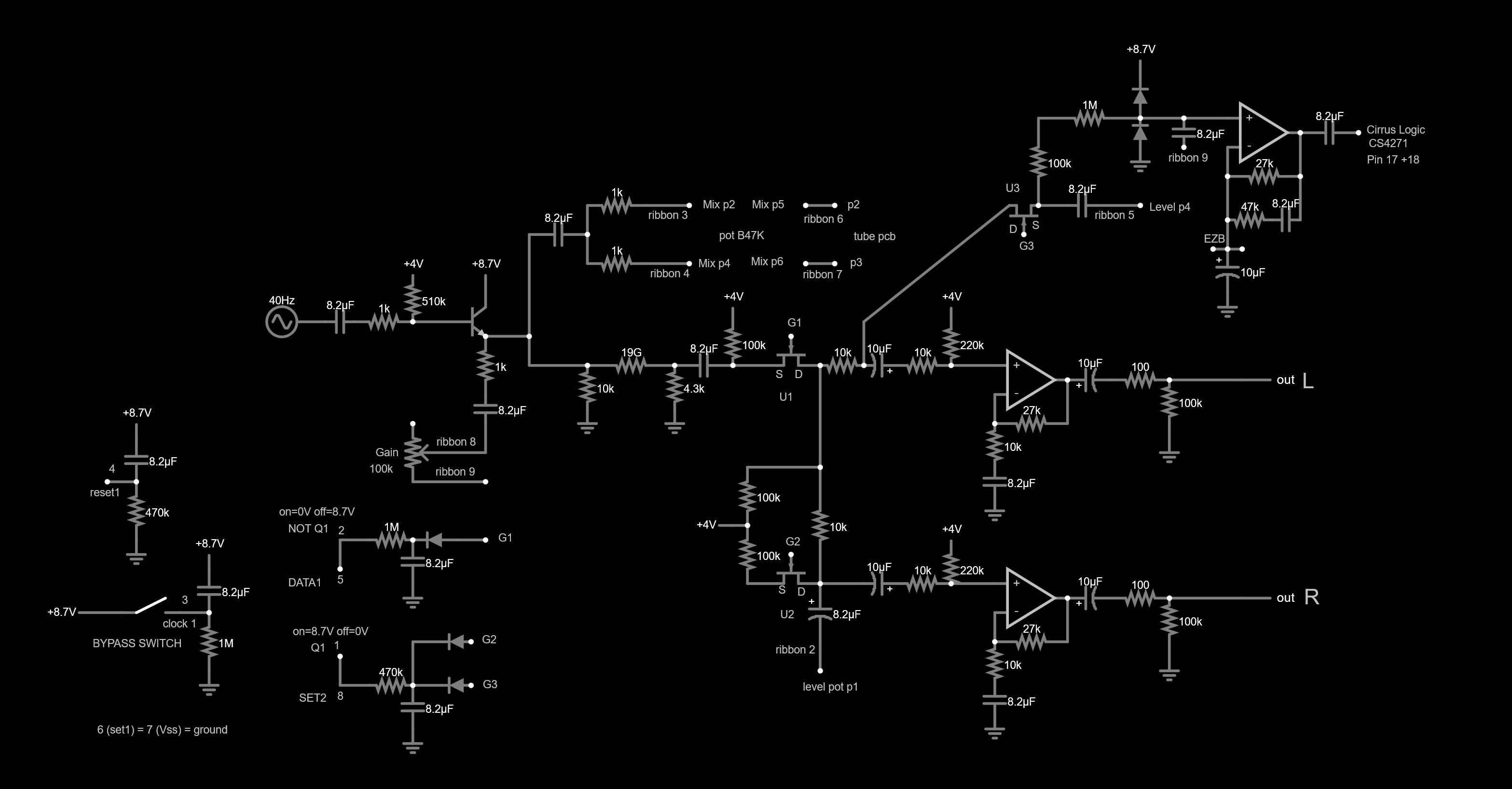

Schematic:

The DC voltages are pointing you to the FETS being mis-biased by the parts around them.
This is why: for a JFET to act as a non-popping switch, the drain and source pins (which are often interchangeable for switch-FET types) must be at the same DC voltage. In this case that voltage should be nearly 5V. To turn a JFET switch on, you let its gate float; this is done by those diodes connected to the JFET gates. When the driving signal goes high, the diode turns off and the gate floats.
To turn a JFET off, you reverse bias the gate-source (actually, gate-channel) diode junction. For this case, the drain-source channel should be sitting at about 5V, so pulling the gate diodes' cathodes down near ground.
The 4013 CMOS Q and not-Q outputs do a pretty good job of rising well above the 5V supply when high and nearly down to 0V when low. The Q and not-Q outputs are tied to either the wet-FET or dry-FETs' gates through their respective diodes, and are always opposite states, so there is never a time when both gate signals are the same - which is what is needed for flipping states.
One of your JFETs is the expected 5-ish volts on both drain and source, the others are not. So the trick will be to find out (1) why aren't all three of them 5-ish volts on both drain and source pins and (2) whether the gate signals are operating right. Use your DMM to find out why all of the drains and sources are not up at about 5V.
One caution: DMM inputs may have input impedances as low as 1M, although most are up about 10M. The high impedance of the JFET gates may mean that a 1M-input-DMM will read the gate voltages low. Don't know about yours, but just keep this in mind.

I've done some more testing and probing. I've also update the schematic with actual voltages.
So, it seems that U1, the upper J113 in the bottom left corner is not working as it should.
As a switch it seems to open in the active mode (reverb on)
As a switch It seems to not close, conduct signal, in bypass mode.
If I jumper the source and drain of U1 I do have a signal in bypass mode and that low volume buzzy distortion is also gone!
Before I swap out the j113 for another one, is there anything else I can check or test what could be causing the 'faulty' behaviour. It's all smd and I don't want to willy nilly start swapping out components.
Below are some photos of the switching behaviour and the voltages I measure between gate and source (or drain). In the previous post I measured to ground.
