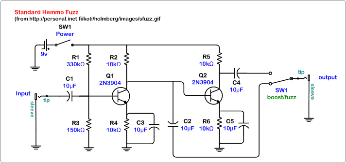

Ok, well the first one was fun. I thought for a follow-on, it would be cool to take that basic single transistor boost as in the LPB1, and add another transistor to make it a fuzz. I searched through a lot of schematics to find something that was both similiar to the LPB1 (to keep in context) and simple. I happened across Hemmo's webpage and found his "Standard Fuzz".
Here is a redrawn schematic. I'll fill in some of the bits I know based on the feedback from the LPB1.
As before, I'll need help in explaining what some of parts do, or corrections to my errors.
What it does This is a simple 9-volt powered transistor device that can provide either a boost or a fuzz sound. Using only the first transistor provides the boost. Cascading that signal into the second transistor provides the clipping to generate fuzz.
9vDC - This is the source of positive voltage and current. Most effects run on a 9 volt battery or AC adaptor. This is where the 9V positive connection is made. The combination of the + voltage source and ground make up the power source. All current coming out of the +9V source must eventually get back to the battery through the ground connection.
SW1 - Switch to turn the power on and off. This interrupts the current from the primary power source, which is a battery or other DC voltage supply. Interrupting either the +9V path or the ground path will deactivate the circuit by by breaking the path from the positive voltage to ground.
R1 and R3 - These components together establish the bias point for the base of transistor Q1. They form a voltage divider which sets the bias voltage, and an equivalent series resistance which limits the base bias current, as well as forming a part of the input impedance.
R2  - This is the component which converts the amplified current in Q1's collector into an output voltage. Any base current is multiplied by the transistor hfe and is converted into an output voltage by ohm's law in this resistor. Remember that transistors are Current devices, so we need to convert the current at Q1's collector to a voltage so it can continue on to the next part of the circuit. The value of R2 sets the output impedance to a large degree.
C1 and R3 - C1 and the parallel combination of R1 and R2, along with the base of Q1 provide a high pass filter at the input. The primary purpose of this high pass filter is to block the DC bias voltage from being disturbed by whatever is connected to the input. Exactly what frequency the C1 and R1/R2 filter cuts off at may or may not be important, depending on the application. Often it is set below all audio frequencies so everything passes. Occasionally it is twiddled to make a treble filter, as in some treble boosters. The finessing of the exact rolloff point of this filter is tricky for beginners, as there are a lot of interactions. But making C1 big enough to pass all audio isn't - just make it big.
R4 -This resistor is a feedback stabilizing resistor. Any current which goes through the base OR the collector goes through here. As such, the collector current going through this resistor raises the base voltage, and reduces the base current - negative feedback of the amount of collector current into the base. R4 also sets the voltage gain of the circuit, to a large degree. Since the base current is small (usually 1/100th or smaller part of the collector current), the R4 current is almost identical to the collector current. Therefore, the voltages across the resistors must be in proportion to their resistances. Since the base voltage must be almost identical to the emitter voltage (that is, only one diode drop, or 0.5 to 0.7V higher), then the voltage at the emitter reflects the voltage at the base. And the collector voltage is R2/R4 times as much.
C3 Short Description: C3 is there to make the gain of Q1 be as large as it can be while still keeping the DC stabilization of R4. Long Description: C3 has an AC impedance that tends toward zero as the AC frequency goes up. In this case, it "shorts" R4's feedback effect at AC frequencies where the impedance of C3 is less than R4's 10K ohms.  That is, at frequencies over F = 1/(2*pi*R4*C3). Since the gain is R2 divided by the impedance in the emitter, the gain goes to infinity, right? Wrong. There is a resistor internal to the transistor's base-emitter junction, called the Shockley resistance that keeps the gain in the same Rc/Re relationship. It's just that the Shockley resistance is not only an internal part of the transistor where you can't see it, it is also a variable. The Shockley resistor is approximately Rs= 0.026V/Ie. It's small, in the few ohms to hundreds of ohms range, so the gain gets big. Here's another description: C3 sets a shelf frequency. The C3 bypasses the R4 resistor setting an EQ shelf. In amps it called  "cathode bypass". Higher values let more frequencies through, more gain and bass. Lower values form sort of a high pass shelf or more gain in theupper mids and high end.
Q1 - This is the first gain transistor. It boosts the input signal but should not normally clip/distort the signal. This can be any NPN such as a BC549, 2N3904, MPSA18, etc. Note that with high gain transistors, it is possible that the transistor's gain will let it distort some. This depends on the exact bias point. It is easy to bang into the + power supply if the bias point of the collector is near the + supply, and vice versa with ground.
C2 - This is a coupling capacitor that blocks Q1’s collector voltage from reaching the base of Q2. See the C4 description for a C2 suggestion on de-popping the fuzz switch.
R5 - As with R2, this component  converts the amplified current in Q2's collector into an output voltage.
Q2 - The second NPN transistor takes the signal from the output of the first transistor (which boosted the signal). This boost causes Q2 to clip the signal as it reaches its operating threshold. Same part type as Q1.
R6 - Same as R4, but for Q2
C4 – As with C2, this capacitor blocks the DC voltage on Q2’s collector from appearing at the output when the switch is in the “fuzz” position. As suggested by R.G., there ought to be a high value pulldown resistor of maybe 1 to 4.7M to ground on the outboard side of this to prevent switch pop.

Circuit 2
« Reply #19 on: July 27, 2006, 04:02:19 PM »
C3 ?
Q1 - This is the first gain transistor. It boosts the input signal but does not clip/distort the signal. This can be any NPN such as a BC549, 2N3904, MPSA18, etc.
C2 - This is a coupling capacitor that blocks DC voltage from reaching the base of Q2 ?
Correct - and this is problematic. I took one look at the C2 part of the schemo and decided that the schemo is drawn incorrectly. That may have been premature, but it's certainly not standard design practice.
C3 does block the Q1 collector voltage from Q2 base. But there is no other source of bias for Q2's base, so Q2's base will not conduct at all until the signal at its base exceeds +0.6V. Then it operates Q2 at high gain (the R6/C5 pair does the same thing as R4 and C3 do for Q1). This would clip off everything below +0.6V from Q1's collector. It will certainly be distorted, conducting only on big positive peaks.
It is possible that this was intentional since the idea was to make distortion with this section. It is also possible that it's a schematic copying error.
The other bug that's related to this is that there is no DC blocking capacitor between Q1 collector and the boost/fuzz switch. Q1's DC level will appear on the output when the switch is in the boost postion, and that will make a major pop. Was there not a capacitor there to block the Q1 collector voltage?
C4 - Blocks the DC voltage on Q2's collector from appearing at the output when the switch is in the "fuzz" position. There ought to be a high value pulldown resistor of maybe 1 to 4.7M to ground on the outboard side of this to prevent switch pop.
C5 - Does the high-gain AC thing for Q2.
SW2 - This switch controls which signal path goes to the output jack. When the switch is in the down position (as shown in the schematic), the output jack receives only the output of Q1, i.e. the boosted signal. Q2 continues to operate and clip the signal; we are just bypassing it. With the switch in the up position, the signal coming from Q2 is sent to the output jack, giving us the fuzz sound.
See the comments on Q1 collector DC level. There should be a capacitor in series between Q1 collector and the switch and another high value resistor to ground on the outboard side here too, IMHO.
