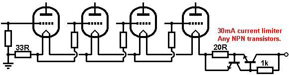

This shows how all the tubes are biased to about -2V. For audio, to prevent feedback between stages via the heaters, I think you would want to split each grid leak into 2 parts and decouple the junction of the two resistors.

And here's a doodle of what I was thinking a DM160 Superfly might look like. I've added variable bias for prototyping- I wouldnt expect to use it in the final version.

The DM160 datasheet says each heater requires 1v / 30ma, so if you ran them parallel that'd be 1v / 120ma. I'm calculating a 91 ohm / 1.32 watt resistor (doesn't exist) would drop 12v to 1v. Therefore an 82 ohm 2 watt resistor in series with two 1n4001 (each drops 0.6v) should get very close.
120mA, you're crazy man! All that wasted power!
I'm gonna figure out a way to keep the current low, so a 9V battery could be used (and last more than 5 minutes). The output tubes can at least be in series if self-split is used.
Hahaha! 120ma is 30 less than a single 12AU7 @ 12v.  :icon_biggrin:

Ok, it can be done with two 1000uF caps. The smallest I've found on Rapid are 12 x 10mm, which I think is actually pretty good.

Merlin, can you explain the heater circuit in your schematic on the previous page please, the two npn transistors. Also, do you think we should start a new thread for the 9v DM160 uFly?
