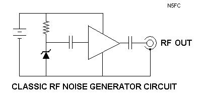

Something worth trying in any BJT-based noise generator circuit is to simply replace said BJT with a Zener diode. You put the Zener in the circuit with the anode grounded and cathode receiving the biasing voltage. Zener diodes are designed to operate continuously in reverse breakdown and also happen to make a LOT of noise when biased at the right point. The cool thing is the Zener trick produces VERY broadband (white) noise, we're talking DC to daylight here. Yet another bonus is you don't have to sort through them, every Zener diode I've placed in a noise generator circuit made just as much noise as the one before and after it (or at least good enough for rock and roll, and definitely much more consistent than BJT's!). Something like a 6.8V Zener should work very well with our standard 9V circuits.

« Reply #44 on: June 06, 2012, 10:50:24 AM »
Would something like this work, or would the 1M be too large to generate sufficient current through the zener?

« Reply #45 on: June 06, 2012, 03:47:31 PM »
Not quite, this is how I do it:
Of course replace the "RF amplifier" with an op amp with some gain (maybe 100 V/V or so). Something to keep in mind is that the gain-bandwidth product of your typical TL0xx op amp is only 3 MHz(ish), so a gain of even 200 will already bring your effective bandwidth down to 15 kHz which may or may not be noticeable depending on who is listening.
Also IIRC the trimpot I used was like 25k and somewhere near the middle of that range was the optimal noise biasing point. It's a simple circuit that at least saves you the hassle of sorting through BJT's, I highly recommend you guys give it a shot before wasting too much time sorting for the worst BJT's in the batch!
