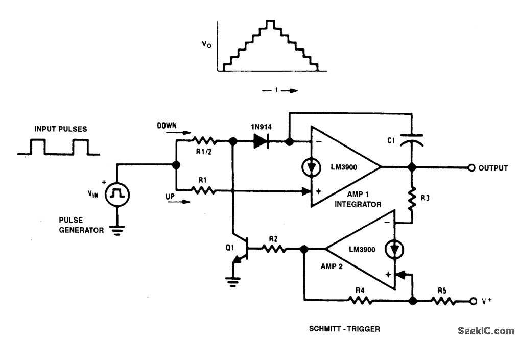

I've been thinking of this way to use the PT's built-in high frequency clock to synthesize a LFO waveform.  Use of the LM3900 "Norton" amp IC allows for a simpler circuit than if you tried to do the same thing with a more general purpose amp.
The RC filter going into pin 2 is just to smooth out the MHz ripple of the LFO's output.
This is based on this circuit from a National appnote, but the key feature here is that the LFO drives the PT2399's Vref pin, which in turn modulates the clock frequency.  This feedback loop changes the triangle-like output of the LFO to become hypertriangular.
I would suggest using this with a very short-delay type of effect like the Little Angel chorus.  Hypertriangular LFOs often sound good with flange-type modulation, so I imagine it would also work well for chorus.
