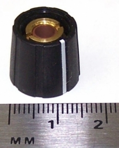

So, I've decided to make my own knows. I'm making moulds and I'm using resin that i can color as well. It looks very nice. I'm making some copies of old knobs from radios etc.
I'd like to make them with a 6 mm push on shaft, so I dont have to drill a hole in the side for a set screw. Does anyone know if its possible to buy the 6mm push part? I would like to drill a hole in the bottom and glue the push shaft into place so it makes a nice 6mm hole.
I dont know where to look for on google. Preferably some kind of metal (material not music)
any ideas. i know i can just buy cheap knobs and take the part out.. but thats not really what im after.

they have to fit something like this.
something similar to the brass part maybe

Why not just mold the 18 tooth spline/knurl? That's how they're made commercially.

https://www.ebay.com/itm/BUSHING-PARTS-FOR-MAKING-YOUR-OWN-CUSTOM-GUITAR-KNOBS-/202482591760?oid=200511973806
from another thread - found searching. you need to know the number of splines ..................
and:
https://www.bitterrootguitars.com/Knob-bushing-for-6mm-shaft-p/152001-50p.htm
that "brass part" is the collet and nut in a collet knob. sifam and alma make the knobs, dunno bout spares.

Thats true.. i can mold them even with a pot shaft inside, but the placing, depth etc would be critical.

Thonk in the UK sell these set-screw brass inserts:
  (click)
I'm sure there must be other vendors selling the same thing?
