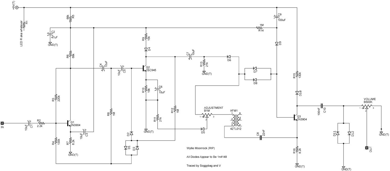

Good call on the Q2 transistor, a higher Hfe then the 2N3904 makes a significant difference in the response of the Octave/Fuzz/Swell pot. After reading your posting, I tried various transistors in Q1 & Q3 and couldn't hear a difference, but Q2- wow! With a 2N5089 there was octave all across the pot, with a 2N5088 it was less, more of a hint of octave where before it was pure fuzz, BC547C responded like the 2N5089, while BC547B was more like the 2N5088. I had looked at the PCB pinout requirement for Q2, and assumed the transistor was chosen for that, and didn't look into the amplification characteristics, sure glad you did!

Well DANG!! Hope you'd be interested at looking at yours, and comparing it to the original traces. As far as I could see, this one seems to be the closest to the gutshots;
R14 is in the wrong place in this schematic (should be directly above D9), but everything else seems to line up with the pictures. Transistor voltages would be excellent.

Russ... got a question...
On your version, the cap between lugs 2 and 3 on the fuzz pot is spec'd as 1uf on the earlier version, and then 10uf on the later. Does it make a big difference on the swell?
Dead End FX
http://www.deadendfx.com/
Asian Icemen rise again...
"My ears don't distinguish good from great.  It's a blessing, really." EBK
Cozybuilder
Dino-
It might be my imagination, but I thought the swell was better with the 10uF cap.
