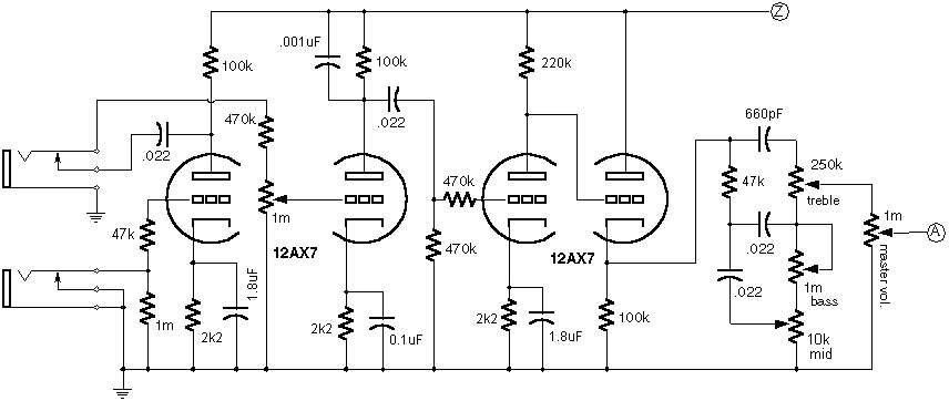

So I am looking around and found some threads on the Carvin Legacy driver and thought to take a swing at that. In reading the schematic I have a few questions.
First off, if there are any resources on how to actually produce a parts list from a schematic and how to learn how to lay it out that would be helpful.
I have attached the schematic I found if you guys are open to helping me learn what I need to put together to build this.
I assume "Input" would be a jack right?
"Volume 1" "Bass" "Mid" and "Treb" "presence" "drive" are all pots right?
cant quite seem to find where the output is here.
Thanks for your help guys. I will be taking extensive photos of the build process so maybe it will be helpful for new people like me.
Quote from: briandress on March 22, 2017, 01:39:10 PM
Sort of.  Typically, you would wire the input to a stomp switch so you could bypass the effect with your foot.  There are plenty of resources out there.  I'll dig up a link if no one else beats me to it.  :icon_wink:
yes.  There are also four trimpots on that schematic.
middle terminal of your volume pot here (unlabeled, but there is a dot there....)

Ok so some parts
A500k "Drive" is a 500k A style potentiometer?
A25k "Mid" is the 25k A style Pot for Mids?
Not sure what these B1Ms are
or the "Gates" are these like and and nand gates?
A and B refer to the taper of the pot.
A is audio/log taper.
B is linear taper.
So, B1M is a 1 megaohm linear taper pot.
The gates are one terminal of a JFET (junction field effect transistor).  The other terminals are source and drain.  You can try 2N5457 JFETs....

some of these caps really are not clear as far as their values are concerned.  like a 47 is 47 farads?
.01 is .01 farads?
i see 47 and .047 as well. are they definitely different?

Quote from: briandress on March 22, 2017, 02:43:46 PM
.01 is .01 farads?
That schematic could use some improvements.  For caps without units, they are in microfarads.
47 is a 47uF electrolytic cap.
.047 is a .047uF (47nF) film cap.
Definitely different.

Quote from: EBK on March 22, 2017, 02:45:25 PM
.01 is .01 farads?
Ok maybe a different schem is in order
