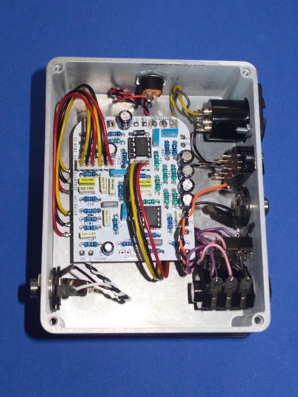

Hey guys, I just finished building an Astrosim revision 2 board with the XLR and Headphone output. I'm having a little trouble with the tone on/off/on switch when using the headphone amp and the XLR out. The normal guitar level output works as expected when flipping the switch and sounds great, but the only way I get output on the headphone and XLR output is when the switch is in the off position. If it's not, I get a really awful screeching and buzzing sound with no output. I tried playing with various schemes of grounding the outputs to eachother or the case, but there's not a lot of change. When I plug the guitar line out into something with the headphone out connected it still buzzes on both, but once I disconnect the headphones the buzzing goes away on the guitar line out. Any thoughts on where I should start looking? It almost sounds like it's ground looping somewhere but I'm not too sure where to look. Thanks for any help :)
One thing I discovered as I tinkered with it some more, the problem clears up if I max out the high tone control pot, but once you raise the resistance up just a tad it comes back. It's the correct B5K Pot and seems to be in spec.
HI man, thats weird, as the tone control is only switching in and out a couple of caps and should have no effect on any of the outputs like that....hmmmm...
did you do the XLR 'bridge' mod as in the the bottom of the pdf?.
drumminkiger
I've added and removed the bridge a couple of times, there's not really any change in the circuit at the moment thought I'm sure I'll want it in once I get past this problem. I noticed someone earlier in the thread mentioning that they were leaking VB through a pot, so I pulled out my multimeter to check and sure enough when the tone caps switch is in the off position, I can manipulate the pot's and the VB stays consistent, but when I put one in the circuit VB varies as I manipulate the pot. What's the correct wiring for the pot's? Maybe I'm just getting it wrong or something? I'm currently just wired Square pad to the 1st lug, middle to middle, and furthest left to the 3rd lug on all 3 of them.

Yeah, that's how mine are wired, so I guess that's good then. I mean't one of the tone caps on the on/off/on switch. When I use the switch to put either cap in the circuit the VB starts changing. When it's plugged in through the normal guitar jack only the VB is consistent through all the switch positions, but I do get a little noise when the high pot is wide open, as soon as I plug in the phones the noise comes back on both the headphone out and the guitar line out. I haven't tried the XLR in a little while, but the behavior was the same as the headphone jack earlier.
strange, i use mine all the time i have it on my bench right now, i have just tested with line out, and headphones simultaneously at the same time and switched the tones,
no problem.......i cant see how just switching caps would cause screeching.......hmmmm....

Have you got any pics.....just curious.
Many eyes on it might spot something.....
drumminkiger
Sure, here's a photo. Nevermind the cap that I just melted a little with my soldering iron last night as I was remelting my off board connections to make sure they were solid, seems to be holding up but I'll likely swap it out when I can get another. Nothing really changed after that happened. Today I bypassed the XLR out  by removing the XLR volume pot to try and limit the problem down and everything is working great except when I get to the very end of the high pot, it starts to trip out. I'm thinking I'll try a different pot of the same value, maybe this one is just crap? I have one on hand that's probably too big to fit in the pedal physically, but is the right value.
drumminkiger
Did some more messing with it tonight. Tried another 5k pot in the high tone stack and nothing changed. I tried it with a quieter amp than my Marshall clone, and found that there is a bit of noise on the guitar output too when the high tone is wide open, but it's less pronounced than the headphone out. If I raise the resistance in the high pot above 6 or so ohms, the noise goes away, the pedal is dead quiet, and everything works great on both outputs. It's almost like flipping a switch and there's a big squeal if I go lower than that, and then at 0 ohms the squeal goes away but it's all hiss and and a super distorted version of the guitar tone. I'm almost thinking I should add a 10ohm resistor to the pot so that it never drops low enough to cause the squeal, but that seems like I'm just covering for something else wrong with my build somewhere. The XLR pot is still out of the circuit to keep it simpler till I get this part dialed in. Maybe theres a resistor somewhere that's too far out of spec?
GibsonGM
Hi Drumm, you'll get it working...umm, pic of the other side of the board if you can?  Wondering how you melted that cap when the serious stuff happens on the other side ;)
I built this and it was fine (Great project in fact!  Lots of fun to use), but at first I had a build error. When probing, I got a squeal at one of the lugs of the "air" pot IIRC.  The cure was to notice I'd left out a load resistor (R20 probably).    These things are typically mistakes we make in assembly, just a matter of finding them!

Quote from: drumminkiger on August 26, 2020, 03:22:59 AM.......I raise the resistance in the high pot above 6 or so ohms, the noise goes away, the pedal is dead quiet, and everything works great on both outputs. It's almost like flipping a switch and there's a big squeal if I go lower than that, and then at 0 ohms the squeal goes away but it's all hiss and and a super distorted.......
It squeals. When C11 C13 are direct connected to IC1_A, it squeals radio waves. You don't hear that but it messes-up the opamp's audio performance, hiss and distortion.
The abrupt shift depends on pot quality, a pot with large end-resistance may not get it into trouble. Yes, 47-100 Ohms series to the pot seems wise.
But it seems it also squeals audio. That is often layout, long wires and sneak-back from output to input.

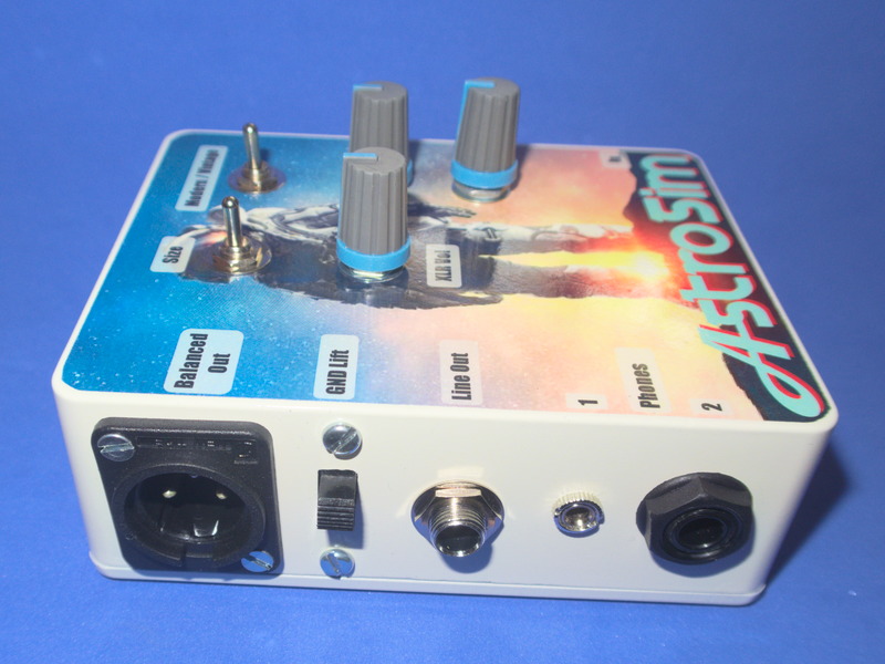

Here's mine:
Added a ground lift switch and a second 3.5mm headphone socket.

It can be hard to make those knobs look good on a build, but they absolutely work there. Looks great 8)
Thanks Nathan, I thought the same.  I've bought a bunch of smaller knobs for Eurorack builds, but the majority use 9mm pots and mine all have smooth 1/4" shafts - these tiny knobs tend to be T18 splined.
 8)
looks great marc.... like the added hp socket , handy , and ground lift too....neato.  8).
Thanks mate - it's a neat little project.  Keep 'em coming!   :icon_cool:
