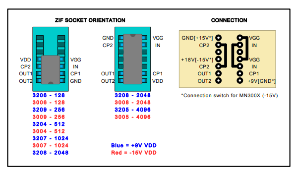

This thread is for progressive experimentation and eventually an all-in-one BBD tester (for MN3XXX type BBDs). I'm mostly thinking out loud and hoping for some feedback from the folks to actually know what they are doing  :icon_lol:
After reviewing one of Armdnrdy's old schematics from when he was hashing out his own BBD tester I've concluded that it can be done very easily with just a microcontroller and a clock source.
For the first trial I'll use a V3102 clock and a mix of MN3204, V3207 & V3205 BBDs.
Here's the waveform the BBD is expecting from the clock (will verify with an oscilloscope)
We should be able to use one of those pulses and read them as a logic high/low signal. Each time it goes high, we add +1 to a counter.
So here would be the steps...
Start test
-MCU sends 5v DC signal to BBD
-Start counting each clock pulse
-Wait for signal to reappear...
-Freeze counter when signal appears at BBD output
End test
This will show BBD stages - plus or minus one I presume
And also verify that it is passing signal
Once I get this going on an arduino I'll have to work out the clock so it can be used universally with all common type BBDs that run off +9v and -15v. Perhaps the v3102 can handle this but the max VDD rating is 12v. Maybe that'll be enough for the MN300X or maybe I can push it a few volts higher.
Here's how I'll likely set up the zif socket. The power requirements for this method is a bit crazy - but ultimately it's more cost effective than using more than one zif socket - and we can run it off the standard 9v and a couple LT1054 ICs.
Be back tonight with a breadboard video.
-KM

320x series can run off 5V supply.  An Arduino runs off 5V.
Can't you drop the 3102 and just generate the clock signals as well as the I/O "data" for the BBD using an Arduino.  You would need to make sure that the clock pulses have an appropriate dead band (i.e. that they are not both high at the same time).
Could just boil down to a programming exercise.

All very true! But the clock and VDD voltages would vary between the 320X and 300X type - the 300X is looking for -15v clock signals while the 320X is looking for +5. So I figured it would be best to keep the clock separate so I can switch between these requirements.
+9v VDD was appealing as it's easier to work with considering my method of power switching while using a single zif socket - see the diagram I've posted.
EDIT - I'm a little concerned about the V3205 having a max VDD rating of +8 while all the other coolaudio BBDs are +10v. So I may turn that +9V into +7.5V. This should also eliminate the need for a 15V regulator for the MN300X supply.
-KM
« Last Edit: December 10, 2019, 12:20:33 PM by Kevin Mitchell »
AFAIK, the high voltage is needed for high clock rates and good S/N. If you are slow-clocking and don't look at hiss, they should all run with 8V power and clock.
And of course + and - come from the ancestral use as digital memory and the conventions of N or P technology. They can all be run with + hot, - common with appropriate re-labeling of pins and signals.

Alright, guys. Before I go on showing my breadboard progress, any ideas why I'm having trouble with the MN300X devices? Simply swapping the power pins does not work for these in my circuit. I'll hit the datasheets again to see what could be the problem.
On the plus side, the program is working fairly well for the low voltage devices. I have to tighten things up to get an absolute stage count but it's very close. This is due to the input pulse being on longer than it needs to be (my programming skills are rusty as well as not so great to begin with  :icon_lol: Trial and error.

The source follower resistor, has to switch with the power & ground.

Actually I have a MN3011 on the way. Could add it by adding another ziff and replacing the read out toggle with a 6 throw rotary. Yeah I've thought about it  :P
The alternative would be to use a few zif sockets instead of just one. That would eliminate the switches. But where the fun in that?
Scruffie - good catch! I might have to adjust the comparitor after the change. I'll scope the output to see if it's actually spitting out signals. Should have done that in the first place  ::)
