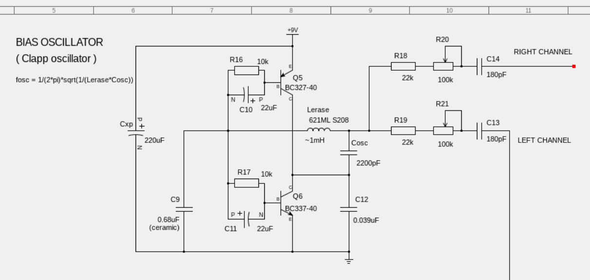

The version 1.0 completed schematic is here (a 1600x1200px sized png image):
The circuit description is shortly this:
The input buffer feeds the input signal directly to the output, but also to the recording amp via a level adjustment pot. The recording amplifier is buffered with a JFET frontend, so that the following low-pass filter won't reflect to the input impedance of the recording amplifier. The high audio frequencies are boosted at the recording, and the high-frequency attenuation will be done in the playback amplifier. The output of the recording amp is taken from the emitter of Q8, where the output impedance is about 2 ohms. The series resistance following the recording amplifier output creates a current drive to the record head and also attenuates the high-frequency bias signal in the return path so that it will not affect the operation of the recording amp. Here is the frequency response graph of the recording amplifier section:
The bias oscillator is a fairly standard Clapp oscillator, providing a 44 volts rms pure sine wave in unloaded condition. Keeping that in mind, the capacitors in the oscillator section need to be rated 63V or more. When loaded with the record head and the record amplifier, the bias signal can be varied between 2 - 20 volts rms, which is just enough for proper biasing even for chrome tapes (but not metal tapes). I recommend using chrome tape over the more common ferric tape, because the chrome tape seems to behave better when recording on top of the previous recording.
The playback amplifier provides a 50 to 60 dB gain and tries to cut the high-frequencies as much as possible, but there is still hiss present due to the huge gain factor. The 6.8 nF C4 capacitor is set to resonate with the 100mH tape head, so that a low-pass resonance circuit is obtained. This provides a steep cut for high-frequencies, which need to be cut, because the huge amplitude bias signal will be present in the playback as well. The frequency response graph of the playback amplifier is here (taking into account also the tape head inductance):
The output is then a simple dry/wet signal mix using potentiometer R21.

jatalahd - is the connection ~R31//C16~C17 correct on your circuit diagram?
don't make me draw another line.
jatalahd
Quote from: duck_arse on November 21, 2020, 09:24:54 AM
Yes and no  :)
The tape heads I use are stereo heads and signal-wise I am using only one channel. The problem in the schematic was that it showed recording signal to be fed to right channel and the playback taken from left channel. Now that is fixed and it shows now correctly in the diagram in my earlier post.
Although only one channel is used for the effect, the schematic shows that the HF-bias is taken to both channels. This is the way I built it so in that sense it is correct, but it might not be necessary to feed the bias to the second (unused) channel. I just though that feeding the same bias to both channels in the record head prevents the magnetization of the head.
I have failed to understand.
No.
But if the bias was built to power two channels, and you only power one, it may put too much bias signal to the head.

Due to further development in thread https://www.diystompboxes.com/smfforum/index.php?topic=126251.0, I am updating this thread with new schematics and sound samples. Just doing it for the sake of someone finding this old version and not the new improved one which I am now presenting here. So here is the schematic of version 2.3, which will be the last update for my project.
The major change is to use a simpler playback amplifier and a bias trap between the record amplifier and the bias oscillator. The topology of the new playback amplifier is adapted from Sony TCK81 tape deck (1980's model) and it performs much better than the one in version 1.0 schematic. The gain of the playback amplifier is still around 60 dB, but there is a dip to 50 db around 1 kHz to make more room for bass and reduce the hiss from the kilohertz range.
The other problem in the version 1.0 schematic was that the record amplifier was loading down the bias oscillator output, which caused some distortion in the recorded signal and low recording volume due to weak bias. Even when adding an untuned bias trap (notch approximately at same frequency as the bias oscillator), will improve the situation a little bit. Best results are obtained when the capacitor value in the bias trap is iterated so that maximum bias signal is reaching the recording head when the record amplifier is connected. In my setup, when the pot R32 is turned all the way down (0 resistance), I measure 44 Vrms @ 57 kHz bias signal at the tape head. Obviously that is too much, so R32 can be set accordingly to provide approximately 16 to 25 Vrms signal, depending on the tape heads and cassette type used. The cheap consumer device tape heads have relatively high inductance, so they need to be driven with higher bias. For best results in my setup I had to use that 25 Vrms bias, since I was also using a Chrome tape cassette.
Furthermore I ordered some "real" tape heads from aliexpress, and settled to use the SS15RAA4 heads. Not really quality heads, but it is an advantage since they have the tape guides in place, so the recorded tapes can be played back in any other tape player. This helped me a lot to debug the recording quality obtained from my build. I also started using a pressure pad under both tape heads, since it seemed to give better quality both in recording and playback. It was a bit troublesome to get a custom pad for the recording head, but a simple soft cushion pad that is usually put under furniture legs was enough for this purpose. Not perfect solution, but adequate.
