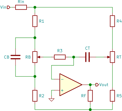

As far as the tone circuit is regarded, I have found some good explanation here https://www.guitarscience.net/tsc/circuit_analysis/baxandall_2.pdf and a nice simulator here https://www.guitarscience.net/tsc/baxandall_2.htm#RIN=600&R1=22k&R2=22k&R3=22k&R4=10k&R5=10k&RB=100k&RT=100k&RF=600&CB=47n&CT=560p&RB_pot=Linear&RT_pot=Linear (you can change the components values and "rotate" the linear pot for both bass and treble).

Another thing that I noticed is that this Barcus Berry 3000A Baxandall circuit is slightly different from the one in the article I have mentioned:
Mine:
Article:
Not only there are 2 capacitors instead of 1 for the Bass, but they are connected to R3 (in my case R4). Why is that?
Quote from: brazuca_nz on April 23, 2025, 12:01:07 AMreally change it to 10uF?
That's barely below the audio band, and you have a lot going back to V_Ref. If you will build a million then you do want to minimize cap-costs; in DIY a 0.1 (film) and a 10 (electrolytic) are about the same price and the difference doesn't justify a lot of figuring. I'd do at least 10. But use your own judgement!
