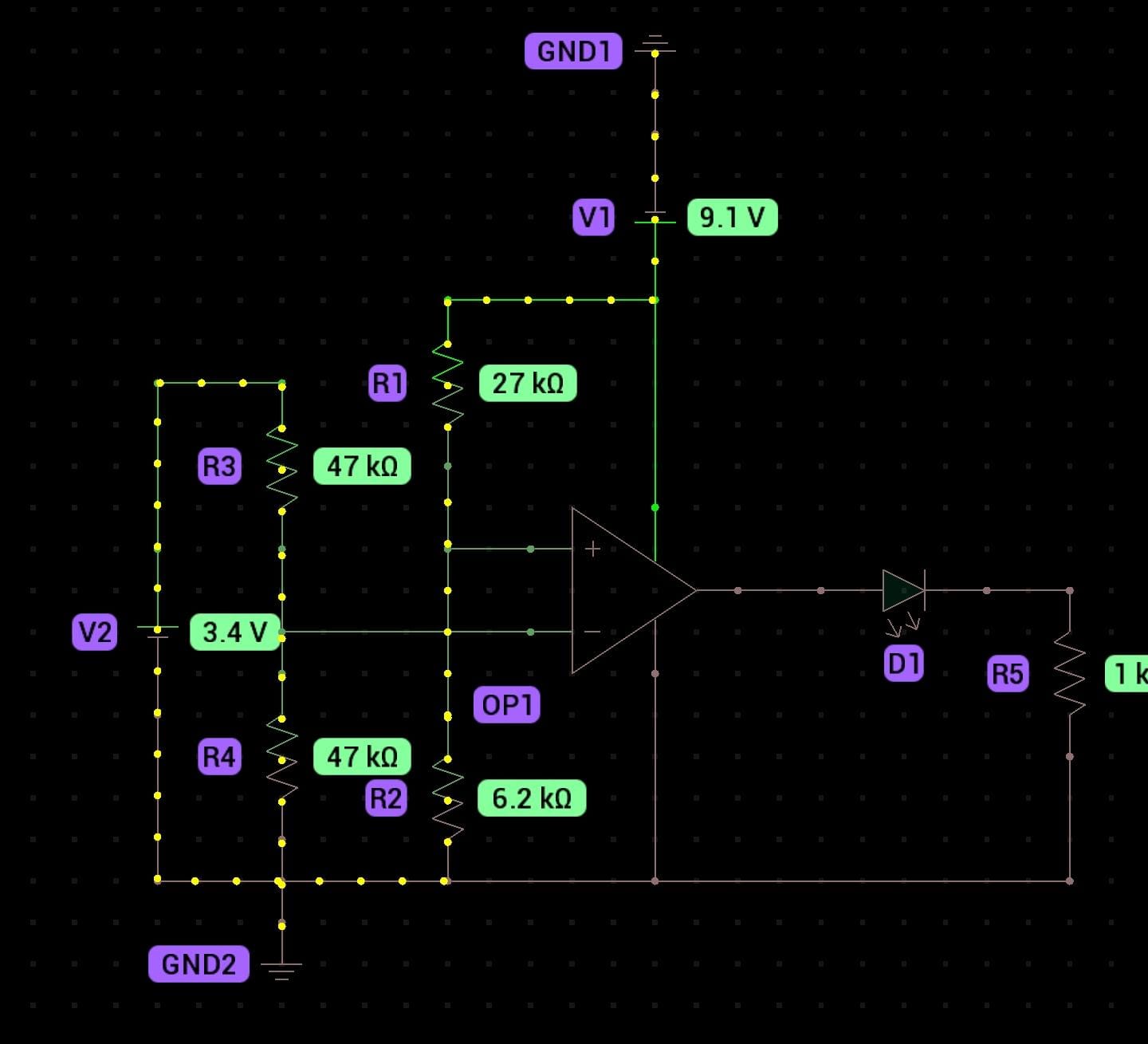

Okay!
Here are the modifications. I also wanted to use the unused op amp from the booster and I found a good use for it: to check if the battery needs to be charged. The circuit I got from ChatGPT so I don't really know if it is right haha. In theory it has two voltage dividers, one for the battery (3.7v / 2 = 1.85v) and another dividing the 9V to get a reference voltage of 1.65v, that is the half of 3.3v (when the battery needs to be charged). Does that make sense?
Then I light the RGB led RED if it needs to be charged, BLUE if it is charging and GREEN if it doesn't need to be charged.
Other than that the circuit remains pretty much the same, I added the resistors and the diode you mentioned.
Cheers!
FiveseveN
Quote from: brazuca_nz on Yesterday at 01:56:32 AMThe circuit I got from ChatGPT so I don't really know if it is right haha
Yes, hilarious.
Is your goal to learn things like how to make an op amp comparator (the battery check) or to rely on AI to do the thinking for you and pray it works?

brazuca_nz
Quote from: PRR on Yesterday at 05:49:55 PMUsing a 3.7V battry to check your 9V battery is...... interesting.
It is actually the same battery (18650 li-ion) that is boosted to 9.1V by the LX-LCBST module. Since I am using the other side of the op amp that is already fed by 9.1V, I need to divide that voltage to compare it to the 3.3V threshold.
Here are some simulations (I changed the values and slightly modified the circuit):
LED off - 3.4V in the battery
LED on - 3.3V in the battery
I will make a prototype to test it. I understand there is another way of creating the reference voltage by using a Zener diode, but I don't know if that would work with the op amp being fed by 9.1V. Is it a better option?

I didn't notice this was a URL, but I googled this circuit a little bit and, based on the smallest Zener I have (3V), I got this circuit. It works on the simulator:
(Led ON when battery voltage <= 3.3B and led OFF when it is > 3.3V)
