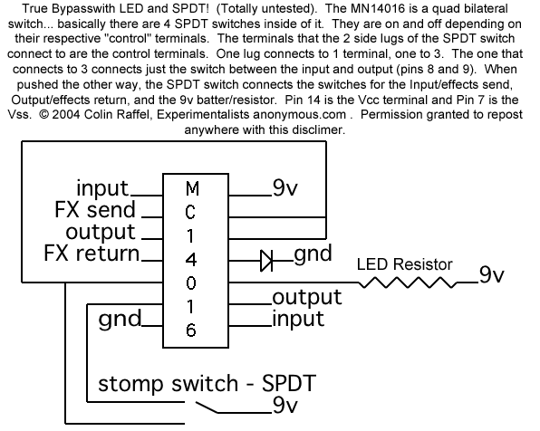

I believe this should work.  Anyone want to test it?  I don't have any MC14016's around.  Any 4016 device will work.
-Colin
The Tone God
:::Scratches head::: Alittle more clearer labeling might be nice but I think I know where your going with this. I'll play with it alittle later but I can see some possible "improvements". Just letting you know that this is not being ignored.

You might want to try something more like this....
In this example, one of the switches is wired as an inverter which makes the transfer time between on and off almost instantaneous. It also reduces the switch requirements even more so you only need an SPST now. Another advantage of doing things this way is that the LED current is not going through the 4016 which will make for a cleaner signal environment.

ExpAnonColin
Interesting, Peter, I've never seen a design like that.  I was hoping to get along to SPST some time soon.  I didn't realize the switching wouldn't be instantaneous.

One source of noise in switching is the time in-between the two sources being engaged. It's not very much, but it's sure there. If you invert the signal from a single control line, you'll get 1/2 as much switch bounce too. The bounce you do get will act a little like a pulse-width-modulated (PWM) blend between the two signals. It would be a good idea to bypass the switch with a small cap too. (maybe 0.1uF) You could also add a D type flip-flop to make an alternating on/off with a momentary switch. Lots of options.

Quote from: Peter SnowbergYou might want to try something more like this....
Peter:
Could a 4066 be subbed for the 4016?  I've fought the 4053 battle and lost.  I struggled with the Wicked Switch over the weekend and failed.  This looks like something I could handle.

You could... but from what other's experiences have been, your mileage may vary. Andrew has a LOT more experience in that area than I do.
Honestly, I do the 3PDT bypass thing or use H11F1s (expensive when you use 3!). I've seen enough struggle to avoid the CMOS switches for effects so far. ;).
Danelectro apparently uses the 4053 so it can be done.... somehow. The enigma continues.

I would call this more of a "semi-true" bypass because the signal is still forced through a couple of caps and the headroom is limited by the CMOS switch. I think it's in a gray area between true and tone-sucking.
In one definition... the signal is lot being loaded by a small input resistor all the time or subject to filtering from that resistor and the input cap (small value) is, so in that sense it is true, but the bias resistors will still load it so it's a tradeoff.

to be serious: it is not T.B., coz it is "semi-conducted", i.e. it goes thru some pn or np semiconductor stuff that needs an operating voltage to be able to fully conduct, and not thru physical conductive material like copper/silver/gold/aluminum... you name`em.

Isn't that sort of how Dunlop does the switching in their late-model wahs? I've got a 'Jimi Hendrix Fuzz-Wah' that uses a SPST for the wah on/off, and it has 3 monster MC14016 ICs on the board. By the way, I took out the smelly old guts and built a vox-type circuit with a red fasel to put in it.

QuoteAndrew has a LOT more experience in that area than I do.
I heard my name used in a non-cursing manner which is a rare thing for me so I'll chip in what I can.
QuoteCould a 4066 be subbed for the 4016? I've fought the 4053 battle and lost. I struggled with the Wicked Switch over the weekend and failed. This looks like something I could handle.
In this scenario you could sub a 4066 for a 4016. Its not like the 4016 flip-flop switch that has been disscussed before that takes advantage of the internal transistor layout of the switch.
This circuit is more optimized just for bypass switching. I thought about releasing a prewired Wicked Switch that is meant for bypassing only but decided to give people the option to do what they want. The WS are meant as general switches to do the same thing as any DPDT switch whould so you could even replace mini-toggles and the like.
I've been thinking about playing with the 4053 to see what it can do. I also need to do some updates to the WS article. Theres a bunch of stuff I didn't get a chance to add on the first go.
If you have had problems with the WS your welcome to post a message, PM, or email me and I'll help out where I can. I have had many successful build reports.
Quoteinteresting stuff, is this technique generally considered "true" bypass or is there some difference in tone?
It depends on how much of a "tone purist" your are or how you define "true bypass". In the most technical manner it is not. In an audio manner I think its good enough. I haven't had a client complain about the switching in the stuff I've built, just the sound of the effect. :roll: What I belive is that you'll get as close as possible to true bypass before going to mechincal means.
I will also point out that this circuit does not allow for the alternate effect input grounding on bypass method of switching wiring since you are giving up a switch to do the inversion.
When I was playing around with solid state switching I did something like this in the beginning. Peter did some things in his schematic that I was going to point out. Mainly that you should not let the switching control pins float and hope that they hit the state you want. You should use pull up/down resistors to make sure the state you want is set. The debouncing is a good idea too.
I did another variation on this by using pull up resistors on each set control signals and using a SPDT ground the desired control pins. It gave access to all four switches.
With this type of switching as the battery voltage drops the voltage to the control pins will also drop poossibly to the point of the switch not operating properly. Its switching performance can be dependant on the input voltage meaning that unless it's voltage is at near logic levels the switch may not open/close fully especially with the 4016. It may open/close partially creating noise and unwanted resistance. Sometimes the switch will even oscilate between states when the voltage hits the right point. Just a word of warning with this type of switching.

Quote from: TriffidAside from not being true bypass, it seems like the savings aren't even that much, at least for us diyers.  At a quick glance... Small Bear has a Carling SPST for $6, which is the same price aron sells his 3PDT's for.  I assume there is much more benefit in large quantities or the big companies would just use 3PDT's too.
Cost wise its about the same in my opinion. The cost of the switch and IC are about the same as a footswitch.
There some places where you can't get mechincal DPDT switches. Using solid state swtiching allows for any kind of switch to be used. You can do long range switching easier with little sound degradation or noise. You are not at the mercy of switch contact issues affecting your audio signal. If your switch fails you can replace it easily without having to hack your effect up or your audio signal suffering.
I'm not saying its perfect and there are downsides that I'm sure everyone can see but its should be given more credit then it has gotten. It does solve some issues.
