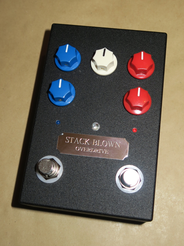

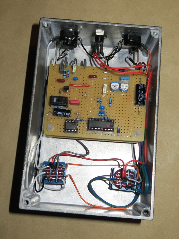

It's been a while since I posted anything here.  Had a small binge over the Christmas break and this is the first one for the new year:
It's a Blackstone OD for my tame guitarist, built to his requirements.  Quite enjoyed the process designing this one.  It's on double-decker perf: the pots are mounted on one piece (and part of the tone circuitry) and the rest on the board you see in the picture, joined by a few links along the top edge.  The indicators are a little different from the original: the central white LED shows effect on/off, and the red/blue LEDs give an always-on indication of which channel is (or will be) active.

That's a great idea using the 2 perfboards and mounting the pots on one.  Very nice build.

Thanks.  Been doing a little muff wiggling DIY on the side (I feel so cheap two-timing you guys...).  Stacked boards are all the rage over there.
